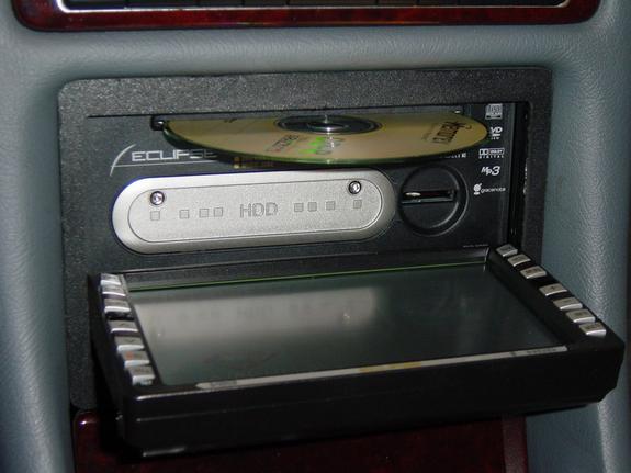

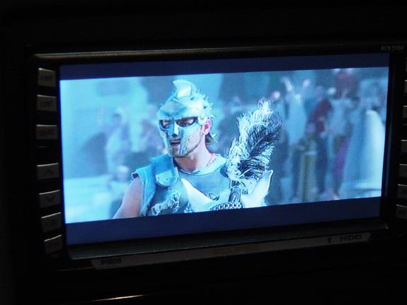

Just had an Eclipse AVX2494 installed recently. It's a 2-din chassis (instead of flip up monitor) which works well in the W208 dash. Also has a 20 GB hard drive - it automatically converts and records audio tracks from CDs, and MP3s can be copied with a memory stick.

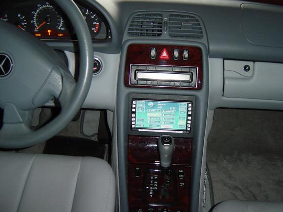

Nice setup! Get some pics of it from farther away , id like to see how it looks with the rest of the interior.

wow, that is awesome. double din = A LOT cleaner looking. i think danny/mmgrad has something similar, but i dunno if his has the hard drive

How about posting another picture of the entire console so we can all see how it looks installed.

Here's another picture...
The Eclipse won't work with the stock amp or front speakers. If you install it in the lower location (which looks cleanest IMO), you'll also need to move the shifter to access the disc and/or memory stick. It also has NAV, but it doesn't work here in Hawaii. I don't have the steering wheel controls on my '99, so that wasn't a consideration. The unit cost $1600 and the install with new front Eclipse co-axial speakers was another $400 or so.

was that trim plate custom made...cuz i had mine done and they didnt that and they just fabricated a suade one but urs looks much cleaner

Very nice!!! Looks like it really fits nicely in the lower section.
