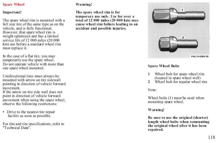

I got caught coming home from the city in the snow storm on saturday and I heard the dreaded sound of a flat. I got out and looked and sure enough I had a flat. After getting the bolts off the wheel (which I removed for the first time) that felt like Arnold Schwartzenegger tightened them. Itake off the old wheel and go to put the spare and the wheel bolts are too short . I was pissed so pissed cold and frustrated that I just rode the rest of the way home on the flat doing 10 mph. Is there something that I was missing? I have the full size black rim spare. Are there some bolts in a secret compartment to be used only with the spare? WTf!!!

Pls see attached page from the manual.

Thanks man I gotta buy a manual I didnt see those bolts in the well but I'll look again.

humm i dont seem to see those spare tire bolts in my spare tire well too, and i have used the spare wheel b4 with the stock nuts and it seem to work fine?
Well, you can get a manual for free here:
