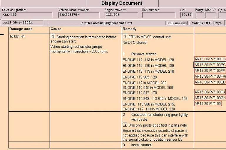

I took a look at my WIS. They do mention coating the starter ring gear with paste. They also mention that too much paste can possibly interfere with a sensor. I attached a section of the WIS that discusses it.

Believe it or not....I ran across the "knock" sensor on the CLK and it also states that bad motor mounts could also "trigger" an error code in the computer from abnormal vibration. I'm a little "new" to the late model Benz line but I've been a certified dealership tech for about 16 years and had never seen this "type" of flywheel monitoring sensor. But it is correct that it will "cut" or adjust ignition and/or fuel if a metallic noise, such as "pinging" occurs. Probably to protect the engine ( 8k reman + labor) and the 4 cats in the exhaust (up to 2k) YIKES. Oh, i can pass on some diagnostic info from Snap-On Tools website that i had downloaded when i had my subscription...simular to All Data. Once you go through the different sensors just in the engine control system you can get a little appreciation in what MB was trying to do. I didnt know that ECM(engine control module) retards engine timing between shifts during accelaration.
