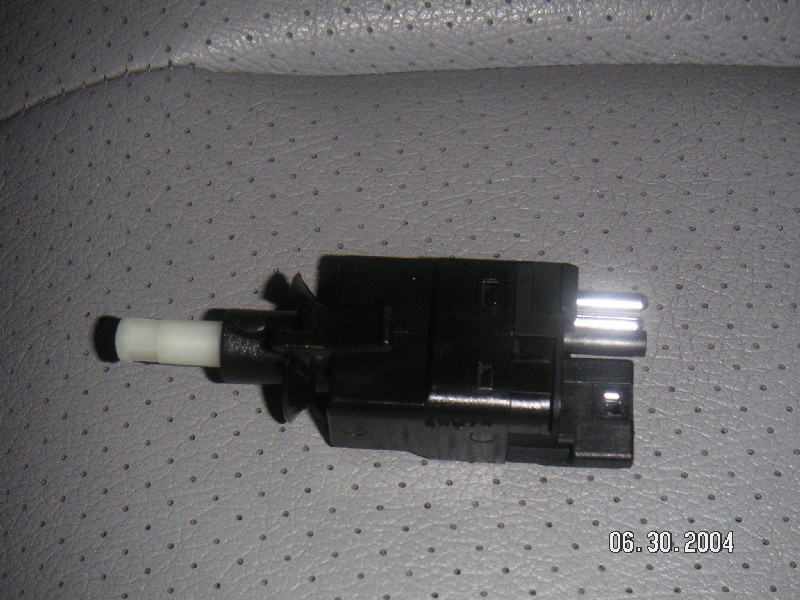

Here is a pic of the actual switch you need.

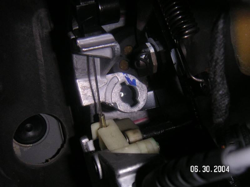

Here is the old switch still in the socket.

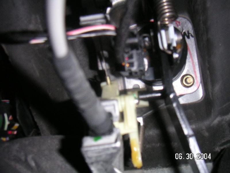

And here is where you stick the new switch.

Thanks alot guys, just one more question, if my stop lamp switch was malfunctioning, wouldn't that mean that my brake lights wouldn't turn on? Cuz my brake lights do turn on. I also tried turning the wheel all the way left and then right and it didn't work.
Old Jul 1, 2004 | 01:50 PM
Brian_I.'s Avatar
Joined: Jun 2003
Posts: 14,362
From: Staples Center
w211 & w124
Not necessarily, my brake lights functioned perfectly but I still got the errors on the ESP/BAS.
