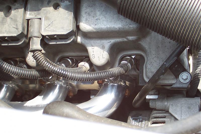

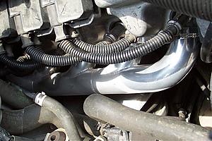

Talking New Mani's Are In!!!
Okay, so I dropped off my car on Monday to get them installed. Straight forward install my SA quoted me 5.7 hours on the re/re of the parts. Tech called me about an hour after I dropped it off and suggested that I get new manifold gaskets, other than that it was smooth sailing.
Got my car back this morning and it sounds great!!! The tone is deeper and more robust. It was a little shrill before with secondary cat delete and the custom X-pipe with the Y-collector.
I have a dyno session scheduled for next week on Tuesday.
Attached Thumbnails *** 208 Prototype ***-000_0127.jpg   *** 208 Prototype ***-000_0129.jpg   *** 208 Prototype ***-000_0128.jpg   *** 208 Prototype ***-000_0131.jpg

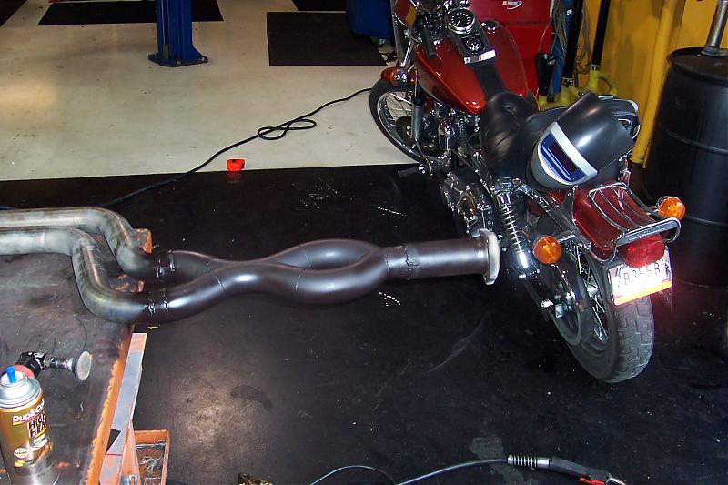

X-pipe & Parts List
Eight (8) 112 142 01 80
Four (4) 170 990 00 10
One (1) 113 016 02 21
All can be found at www.oempartsdirect.com

Ghost,
what is that pipe you are showing? Is that the rear exhaust?
Thanks
Brad

Originally Posted by otoupalik
Ghost,
Thanks
Brad
Hey B-Rad,
Yeah... That's the section of pipe that connects to section with the resonator which leads to the muffler.

Can't wait to see dyno results. headers look great

First off, congrats on the manifolds. They are close to the log manifold that we made many moons ago and we did get some nice gains. Cannot wait to see your dyno's!
Originally Posted by Ghostrider
Hey B-Rad,
Ok, that is what I thought, but did not want to make any assumptions.
So based on that rear most merge, I think that you are going to loose HP (or at least limit any gains from the other mods up-stream) with that. You really want to have a proper "Y" to smooth the flow prior to the muffler. In fact, doing an X directly into a Y offers little gain over just a Y. Ideally, you would do the X upstream and a nice Y later in the system. I wouldn't remove the X now since it is done, but I would replace the Y or merge with something like this:
You can see more HERE and HERE
That one change could (not saying 100% as there are no guarantees with car modding), but it COULD make a big difference in your overall system.
The quality of the X and Y pipes in a system are hugely important. I have seen a lot of "shops" make X pipes very wrong and the result is always very little power gain to worst case a fair power loss. Exhaust flow and resonance is critical in keeping the energy flowing and in fact accelerating out of the pipe.
Also, ideally, this is the type of X that you would want to use: (but again, looking at the X your guys made, it is not that bad at all)
See how the transitions and flow pattern are gentle? With yours, the merge at the base of the "Y" basically dumps the exhaust into each other, creating a wall of turbulence, rather then allowing each pipe to scavenge from the other and preventing both from smoothly flowing and accelerating the total exhaust gas into the muffler.
Does any of this make any sense?
Thanks
brad
Makes perfect since!!! That's why I now have a Y-collector just like the one you have pictured!!!! I learned an X-pipe is usually reserved for a true dual exhaust system like the ones on a W211 E55. I figured having the X there couldn't hurt, and if it help great.
It was doing exactly what you just described, and it sounded funky to boot. Like the exhaust gases were smashing into one another It took a lot of question asking and reading but I eventually figured it out.
Thanks for looking at it and offering your guidance. I love your products (rockin the evosport pullies) and the service is always top notch.

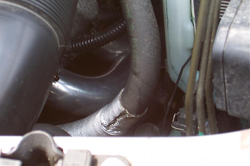

Do you have any pics of the exhaust now?
thanks
brad
It looks pretty much like the picture except that it was cut and this piece was added.
Much better!
