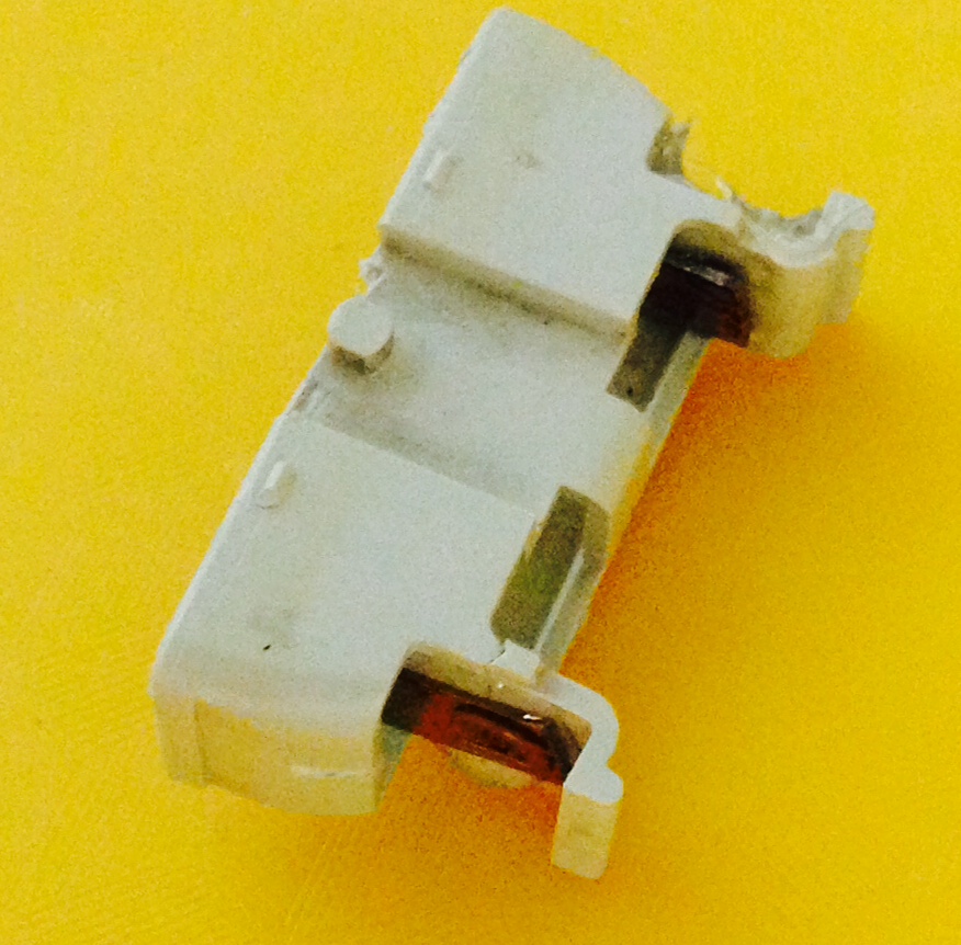

Alright...this is how I fixed mine, and maybe it will work for you guys. It's not a feat of engineering, but it sure beats paying hundreds of dollars.
I'll explain what I did, and then show you some pics of it.
Some things you need:
Plastic to metal Epoxy (or regular Epoxy seems to work)
Tweezers & 2-4 small pieces of metal cut to size (you'll find out below), very fine, tiny paint brush.
First, take a credit card or something that is "soft plastic" and pop off the the fan control button. Behind that, is going to be the the actual piece that pushes the buttons (pictured below).
Now, take a set of small, needle-nose pliers and clamp them down on either the top or bottom of the button. Pull it out...carefully! It's very easy to break this thing in many places. However it will be difficult to pull-out.
Then find out which part is broken. Mine was broken right in the middle of the the prong that pushes the button at the back (look in the opening and you'll see what I mean). If whatever piece that is broken is not still hanging on the the button itself, it should be left in the opening or it's somewhere in the control unit. You may need to take the entire unit out and shake it to find it. It's in there somewhere.
Anyhow, you're basically gluing it back together, and using some thin pieces of metal (or plastic) to act as a tourniquet on both sides of the the plastic arm (pictured below) for reinforcement. Use the paint brush to paint on the Epoxy. Use the tweezers to carefully place them on the button, and let dry. I would suggest doing this to both prongs. Pounding on the button over time is eventually going to break it unless you're very SLOW when using the fan control. Pretty simple.
Yet, you have to be very patient. This is almost like an operation because you're dealing with very delicate, small pieces of plastic.
Look at the pics and you should be able to see what I did. Hope this helps some of you out:

Thank you so much. I'm enclosing some pics if they might help anyone else understand this procedure.
Attached Thumbnails Air Conditioner Button Broken-img_7110.jpg   Air Conditioner Button Broken-img_7111.jpg   Air Conditioner Button Broken-img_7112.jpg
