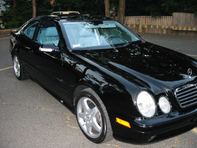

If you're new to the lowering game, watch out for speed bumps and concrete barriers at the front of parking spaces. I got my front end caught on the bolt that secures those barriers to the gound. The bolt was sticking out further than it should have been. I cleared the barrier no problem when I parked, but when I was reversing the front spoiler got caught and took a two inch chunk out of the bottom. I also barely cleared one of those speed-bump like things with the teeth in a rental-car parking lot. It was an isolated case since it was installed on the crest of a hill. No significant damage but a valuable lesson learned in both cases. I love my car lowered but you have to think about ground clearance much more than you would think.
They say your car settles over time and I think my car is noticably lower over the past year since I had the H&Rs first installed. Although the pic is kind of blurry, you can get a good idea about the ride height with the pads I mentioned above.

Old Mar 7, 2003 | 07:45 PM
LOH's Avatar
LOH
Joined: Nov 2001
Posts: 99
oops, forgot the pic

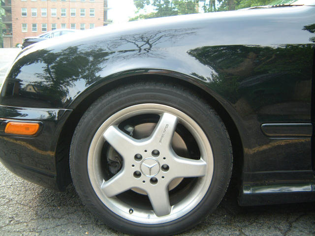

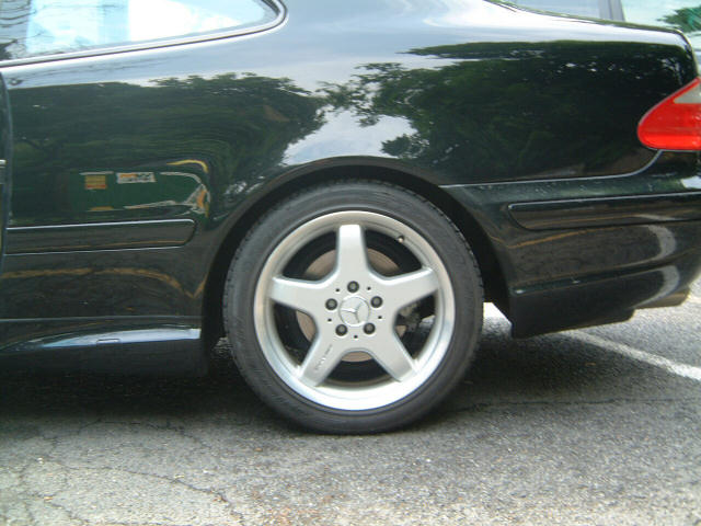

EFF YOU JACKIE
H&R Pics
Hey guys, finally did the H&R's, don't mind the dirty pics, car sat outside when it rained, while at my girls house.
1.4 drop up front
1.12 drop in rear
Also, have had the H&R's in for a while, and occassionally I get what sounds like a pop or crack, almost like the brake pad is banging on the roter, but MB says brakes are golden, and that it may be the "new" suspension.
Old Jul 8, 2003 | 09:54 AM
ldangeli's Avatar
Joined: May 2002
Posts: 1,030
From: Hell
EFF YOU JACKIE
Rear
Old Jul 8, 2003 | 09:57 AM
ldangeli's Avatar
Joined: May 2002
Posts: 1,030
From: Hell
EFF YOU JACKIE
Front
Old Jul 8, 2003 | 11:12 AM
mmgrad's Avatar
Joined: Jul 2002
Posts: 5,289
From: So Cal
W213 '17 E43 ///AMG - W211, W208 no more
Originally posted by ldangeli
Rear
Ok... I know someone will say it, so I may as well be first... LOWER MORE!!! hehe
It looks good, but I think you needa lower it a little more to get rid of the wheel gap...
Any pics of the whole car?
Old Jul 8, 2003 | 01:05 PM
ldangeli's Avatar
Joined: May 2002
Posts: 1,030
From: Hell
EFF YOU JACKIE
Gonna put 18's on there, so it should remove most of the gap. If I lower it anymore, I won't get in and out of my driveway! LOL.

Old Jul 8, 2003 | 02:47 PM
mmgrad's Avatar
Joined: Jul 2002
Posts: 5,289
From: So Cal
I have pics of the whole thing on the CLK Picture thread! All shined up too!
depending on what size tires you use, it may or may not reduce the gap... but the change should only be marginal...
Old Jul 8, 2003 | 07:48 PM
LOH's Avatar
LOH
Joined: Nov 2001
Posts: 99
mmgrad, sorry for the late reply. I didn't notice your question back in March. Anyway, yes my car is lowered. I use H&R with Koni adjustables and couldn't be happier with the look and performance. My car came from the factory with size 5 front and size 3 rear spring pads and I kept that arrangement. They say over time the springs settle a little and I do think my car is a little lower in the 18 months since I changed the suspension but it may be my imagination.
