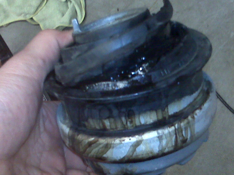

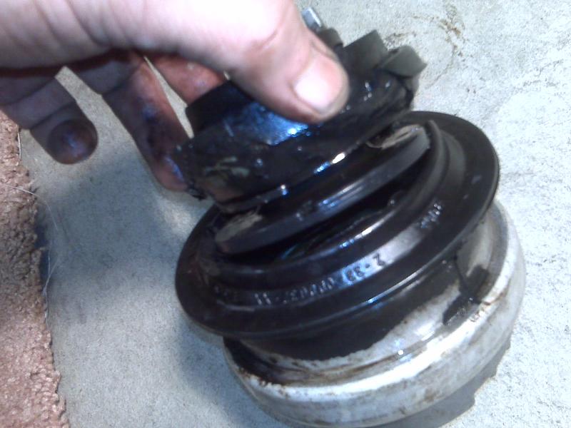

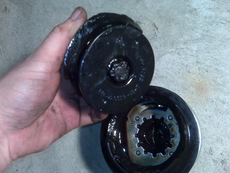

I realize there are tons of threads on motor mounts but I havent seen posts regarding the design. An mb member posted https://mbworld.org/forums/clk-class...ount-ever.html I checked mine and the motor popped up 4 -5 inches just like the vid!! Other than some vibration while stopped at D or R, there was nothing to indicate that the MM was in this condition. The driver side mount came out in 2 pieces..
The question is.... what is supposed to stop the engine from rising up like that even with a new motor mount? It looks like a week rubber stop (2nd pic) and the rubber boot is the only thing preventing the torque from destroying the motor mount.
Does anyone if this is the same on the w209 mounts? Is there any aftermarket alternatives?

your mm is broken. When I took mine out, they were drained of oil and had lost all hydrolic pressure, however they still would not extend past the physical stop point. You'd have to hammer on that broken mount for a long time to break it completely.
Mike
