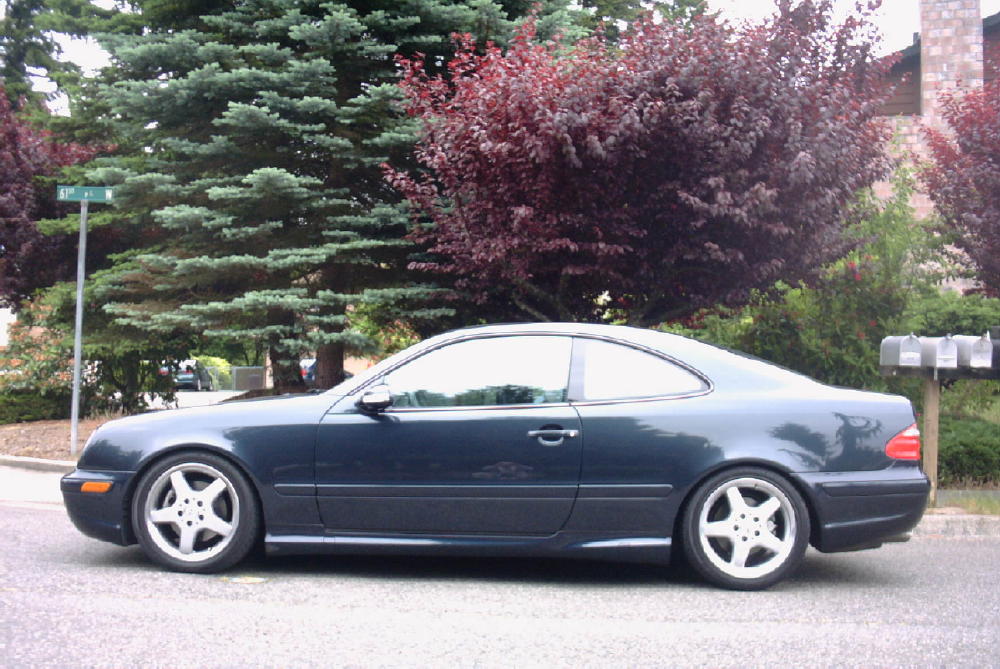

Old Jun 19, 2003 | 06:09 PM
hinhin7's Avatar
Joined: Feb 2003
Posts: 521
From: Washington
MB
Danny.. i think my front sits a little bit lower than yours.. hahahah :-)
probably H&R springs lower more than Brabus spring.
Nice car man...
Attached Thumbnails Install a H&R Cup Kit on CLK430 w/ stock 17" rims?-clk-ceper-samping2.jpg
Old Jun 19, 2003 | 06:44 PM
mmgrad's Avatar
Joined: Jul 2002
Posts: 5,289
From: So Cal
W213 '17 E43 ///AMG - W211, W208 no more
Nice car man...
yep, you right... i think ur front sits marginally lower than mine... not sure about the back though
Is ur car black opal too? love that combo of black/blue/green/purple.....
