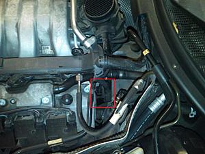

Found the CPS on my CLK320, from pictures a SLK320 (see attached).
Was pretty much the same as a 430.
Didn't see the torx screw however, covered by a plastic cap?
Getting to cold here in the Boston area for DIY, so given that my only out of pocket repair in 80,000 miles has been a quick and simple DIY MAF replacement, after reading more on the ubiquitous CPS failure will check with local dealer and an independent mechanic regarding $ to have it replaced.

Surprisingly, access to the CPS on a 320 doesn't look to be a piece of cake.
If it were warmer, would DIY, but to cold now in my unheated garage.
Dealer in Lynnfield quoted $475 to replace.
Decided to have it done by an independent (X MB) mechanic in Peabody who quoted $275.

Had the independent mechanic, that sometimes use, replace the CPS this morning.
It was bitter cold here (e.g. 6 degrees F) and the car stalled on the way to the shop at the first traffic light, but restarted before the light turned green.
He had it replaced in under 10 minutes, including checking for STAR diagnostic codes and only charged $136 for the part and labor.
Hint: He used a long extension (maybe 3') between the E8 torx socket and ratchet, thus no scraped hands, aching back.
