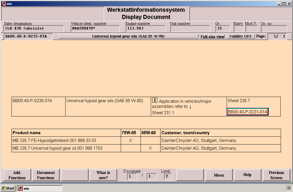

The WIS says, rear axle standard differential SAE Grade 85W-90, 90
and 85W-90 for limited split differential.

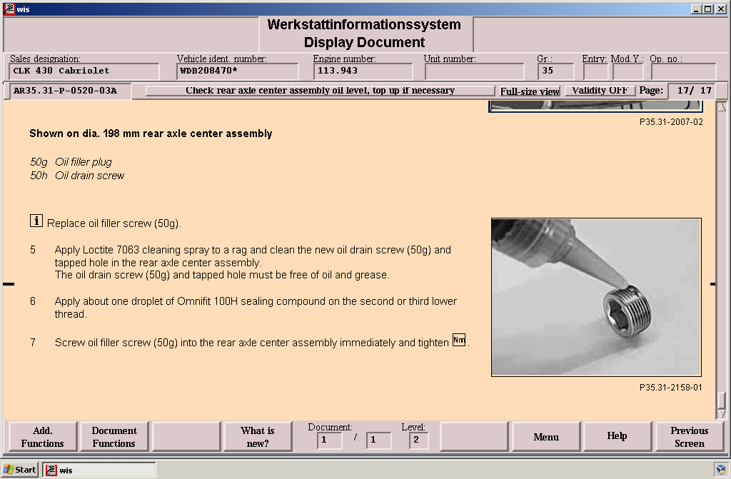

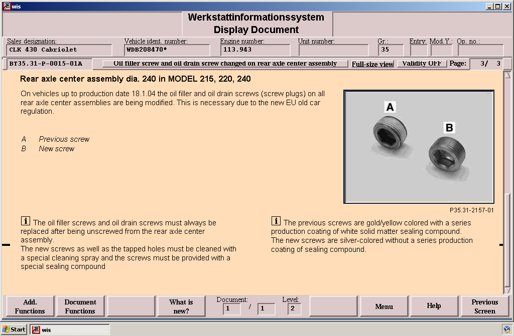

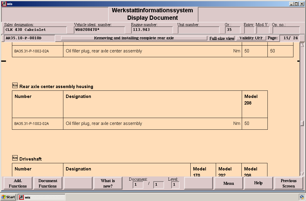

Here is some good info from the WIS (2006). Apparently synthetic was used after 4.11.2001. See below.
Not to confuse, but Germans use Day/Month/Year, Americans use Month/Day/Year.
Not sure which format the WIS is using.
Personally, I wouldn't hesitate to use non Mercedes gear oil.
Edit: I see a date down there of 18.01.04 so it must be D/M/Y.

Is anyone using the Omnifit 100H when doing the rear diff? If not, what are you replacing it with, if anything?

The Omnifit 100H is a thread sealant specified by MB for the drain plug, not the oil that goes in the diff. marko69 shows it from the last screen shot attachment he posed on 12-23-2014.

Ah, sorry,,
Yeah, this "Omnifit 100H" is normal threadlocker with medium strength,
usually used with soft/fine thread like this oil drain with (1-pitch),,
but you can use any good threadlocker with medium viscosity strength..
