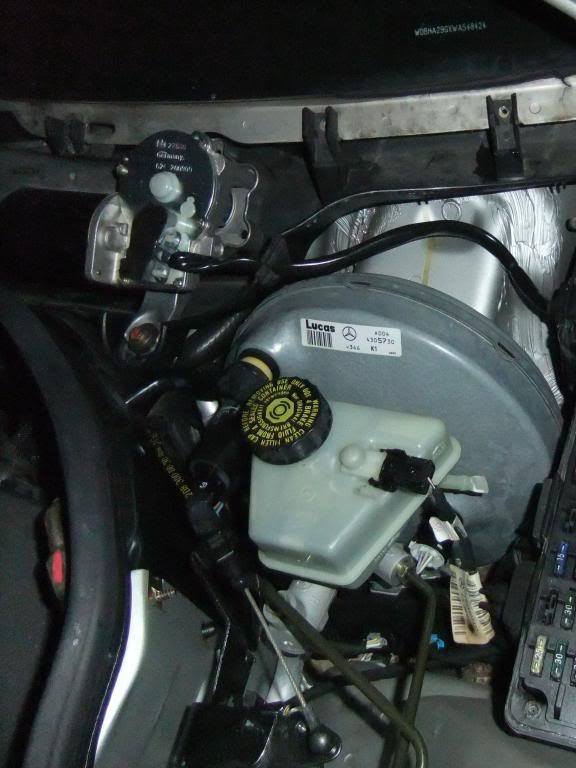

It is drive by wire, it's just not your typical modern setup. The sensor is not in/around the gas pedal itself, it's in the engine compartment. The gas pedal pulls on a metal wire, which then drives the sensor. You can find it next to your brake fluid reservoir, here's a random picture of it with the throttle wire on the lower side:
