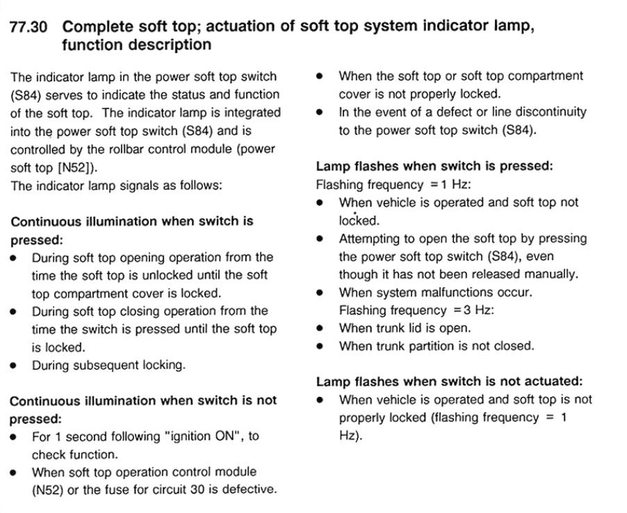

Yes, of the roof is not fully locked, you'll get the warnings you mention.
Dollars to doughnuts, it's more than likely the soft top case cover or rear bow locks, caused by a malfunctioning hydraulic cylinders (e.g. leaking), which has been a very common problem. Note: If your fault is an unlocked roof, your console trunk release switch will not function, due to a built in safely interlock to keep the case cover and trunk lid from colliding).
Additionally, the flashing lamp in the main power roof operating switch, also provides basic fault diagnostics, see enclosed details in the enclosed thumbnail.

In the interim my first suggestion to end the alarms, would be to manually lock the case cover and rear bow. Details of each procedure is covered by 'how to raise your roof manually', in the practical hints section of your owner's manual. Note: the procedure includes reducing the hydraulic system pressure, which will also reduce the puddles of hydraulic fluid, if your cylinders are leaking.

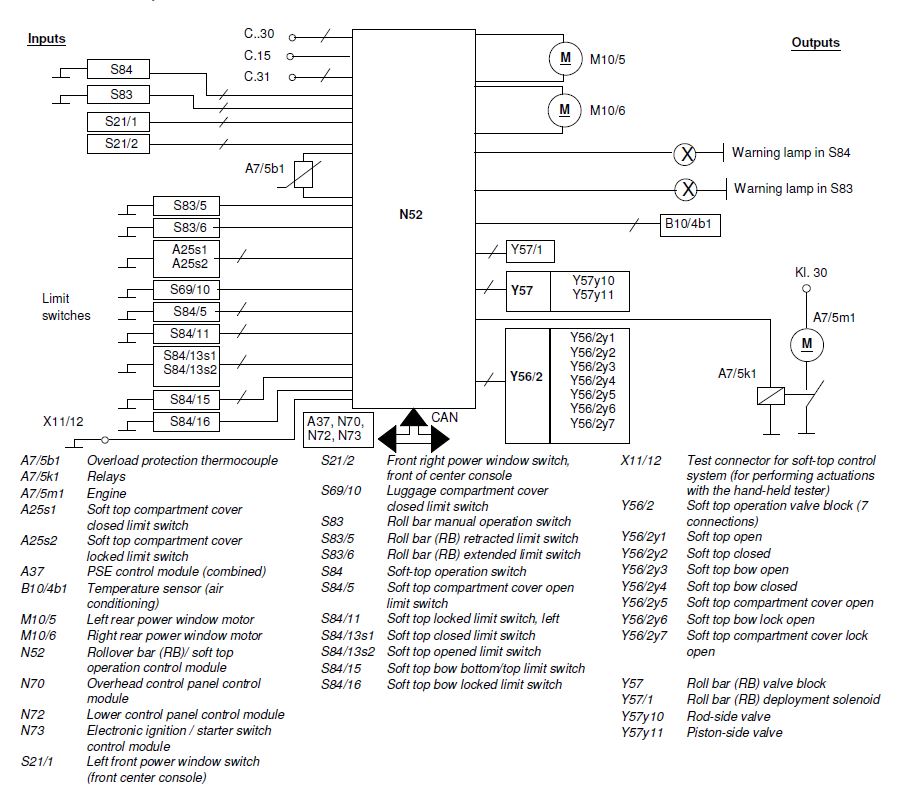

Alternatively, see the enclosed functional diagram of the power roof/roll bar controller (N52).
The controller inputs are shown on the left, the outputs are on the right and connections to the CANBus, which can be inputs or output, are on the bottom.
The controller is fused in 3 places (e.g. C.30, C.15, C31 inputs). The warning lights for the main power roof switch (S84) and Roll bar switch (S 83) are outputs.
Our A208s, have 4 fuse blocks.
Fuse block F4, located in the trunk, has 2 of the controller fuses. Circuit 13, as I recall is a 40 amp fuse, only protects the pump motor. Don't bother pulling this fuse, or the pump motor relay, as the circuit does not power the N52 controller. However, Circuit 11, as I recall is a 15 amp fuse, is one of two fuses that does provide power to the controller. The other source of power to the controller, is Circuit 15, as I recall is a 5 amp fuse, and is located in fuse block F1, which is one of two fuse blocks, located in the engine bay. My best guess would be to try the later fuse as a first attempt to shut off the warning alarm.
The reason I suggested manually locking the roof, is that electrically turning off the N52 controller will have other consequences. For example, rear window motor operation (e.g. M10/5/6) and/or other CANBus attached controller functionality.
