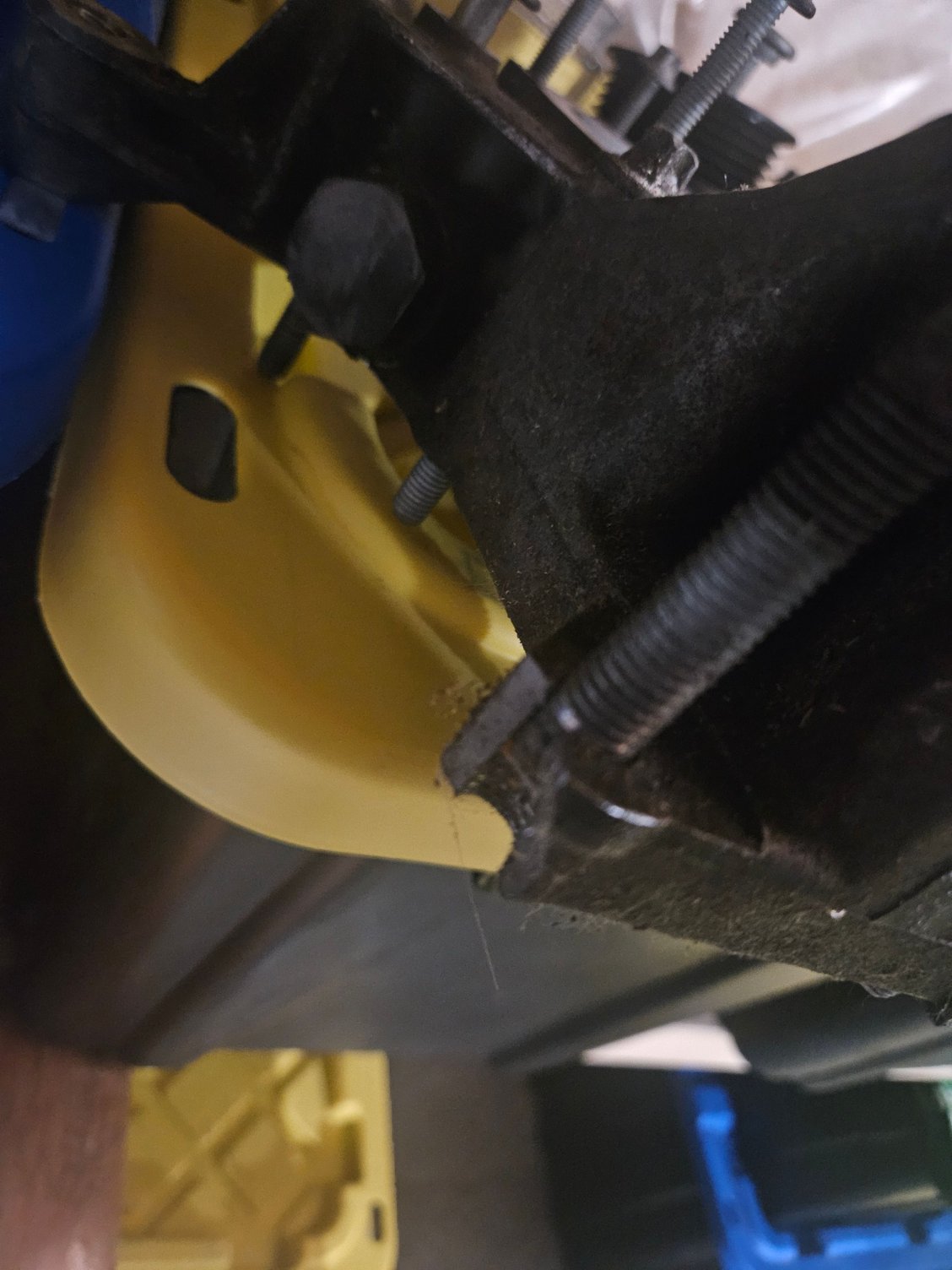

First I had a screw shear off on me while trying to reattach my water pump. This caused me a significant delay as I researched replacing the entire timing cover (huge job) or trying to extract the screw (tried everything, didn't work) and heli coil in a thread. After finding out the scale of the timing cover job combined with the cost ($450 CAD + $200 threading) I opted for the heli coil.
The job was a pain and cursed from the get go. After pushing to hard trying to drill the son of a ***** M screw out I ended up breaking a diamond bit off in the middle of the screw...which made extraction a pain. Ultimately, I had to go it with ceramic diamond tipped tile saws (with hole in the middle for broken carbide drill bit) to get it out. That process *******ized the existing threads so I bored the hole out and put a heli coil in. Fingers crossed it would hold...
I put everything back together and no **** the ***** ****a is leaking right from that spot where the heli coil is. Just not enough pressure I guess to keep the pump gasket tight against between the timing cover and water pump facia. I was gutted. Under the knife again...

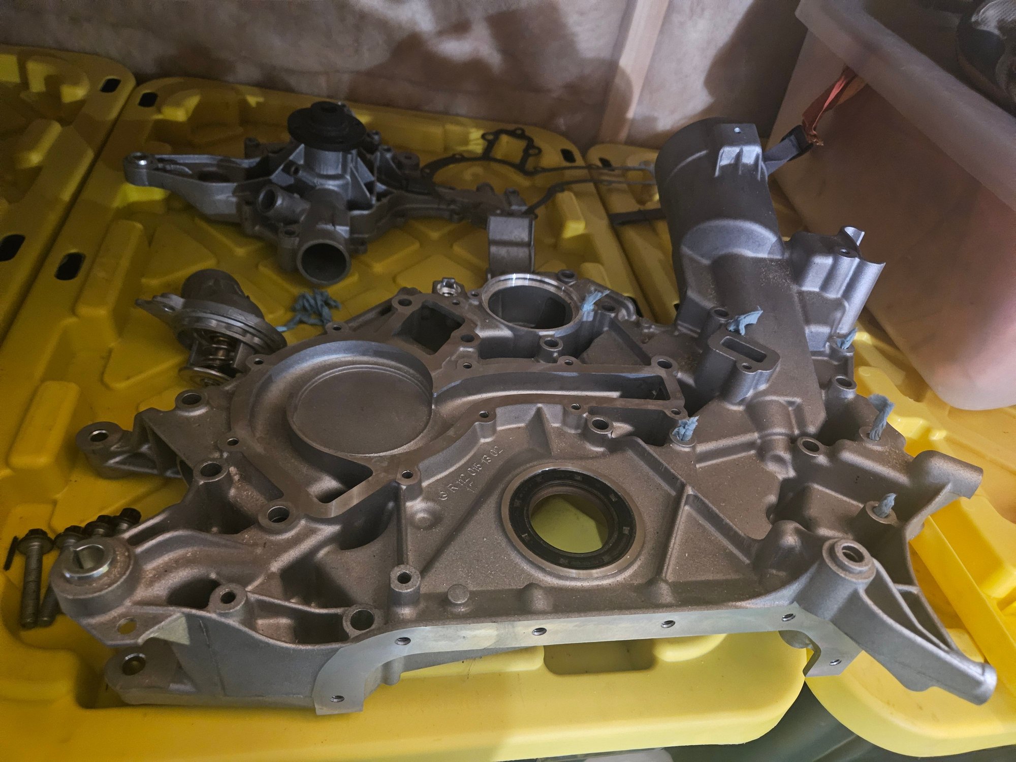

I decided to do the job right and order a new timing cover. The final nail in the coffin was when my alternator screw broke off in the timing cover too taking everything apart again. I guess working outside in the cold is not great for these type of jobs...or I'm ****ty with screw tension.
New timing cover is gorgeous. Can't wait to have it installed and have this part of the rebuild behind me. Right now I'm almost done taking the old one off. It's hard to get at and you need to remove the following items to take the timing cover off, in no particular order:

Heli coil that didn't end up holding. Getting to this point itself was a pain in the ***...never mind where I'm at today.

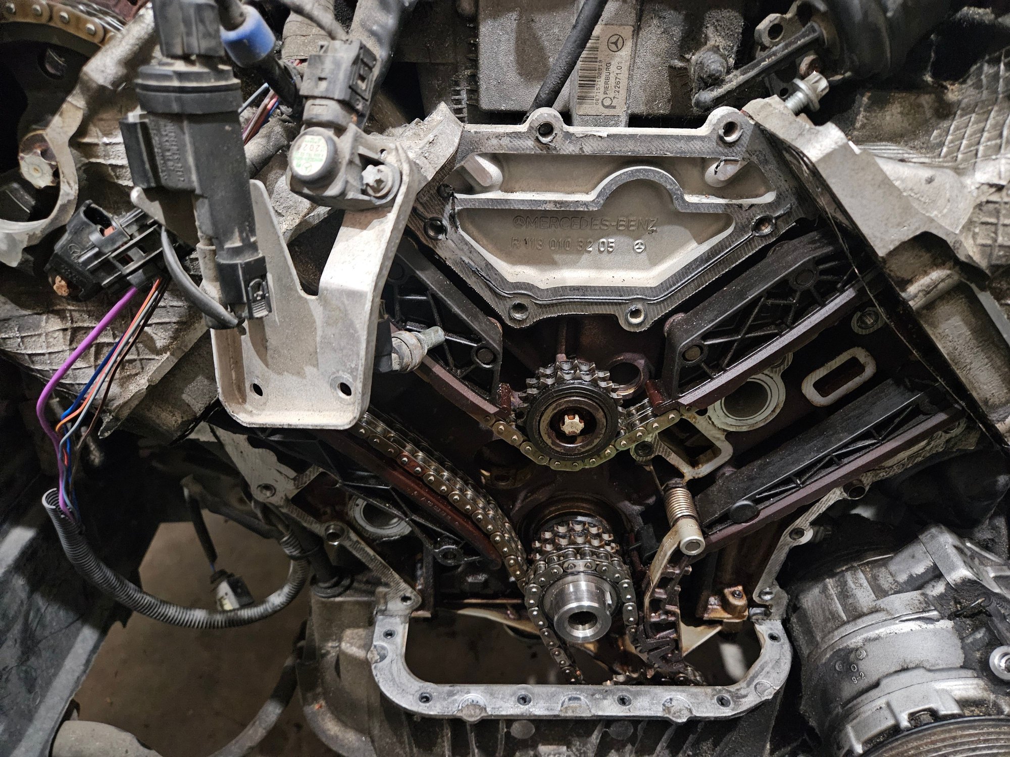

After letting the car sit since 2019 due to a purchase of a new truck I started at it again as I wasn't getting what I wanted part out wise or outright sale wise. Figure why not give it another shot.
Finally got the old timing cover off. Let me tell you this is a huge pain in the ***. The old timing cover had a heli coil in it for one of the waterpump bolts...it held together ok. Although when I tried to put one of the alternator bolts back in, it got cross threaded and broke off a key piece of the timing cover. I got a brand new one (wasn't cheap) and finally got the old out yesterday. I did make one more mistake taking it out though. I forgot to take out the timing chain tensioner bolt and it ended up cracking one of the guide rails for the timing chain. Ooops. Not that big of a deal though...a new one is only 90 bucks Canadian and while I'm this deep into the engine I may as well replace the timing chain since I have such good access to it. Will likely bring some new life back into the car. Also started cleaning some of the older parts that got covered in dirt / oil over the years so i'll shine it up nice and make the engine bay look as good as I can. Some pics below of where I'm at. Old timing cover with heli coil install & broken alternator bolt port. New timing cover, new waterpump, new idler puller, new thermostat all coming soon.
Have a question for anyone that may know...although I'll likely start a different thread on the topic.
Do you have to remove the valve covers to replace the guide rails? Or just the chain? Should I just put a new pin in the timing chain? Or replace the entire thing? Chain still appears to be pretty stiff with little to no play. Can has about 140,000 miles on it.
