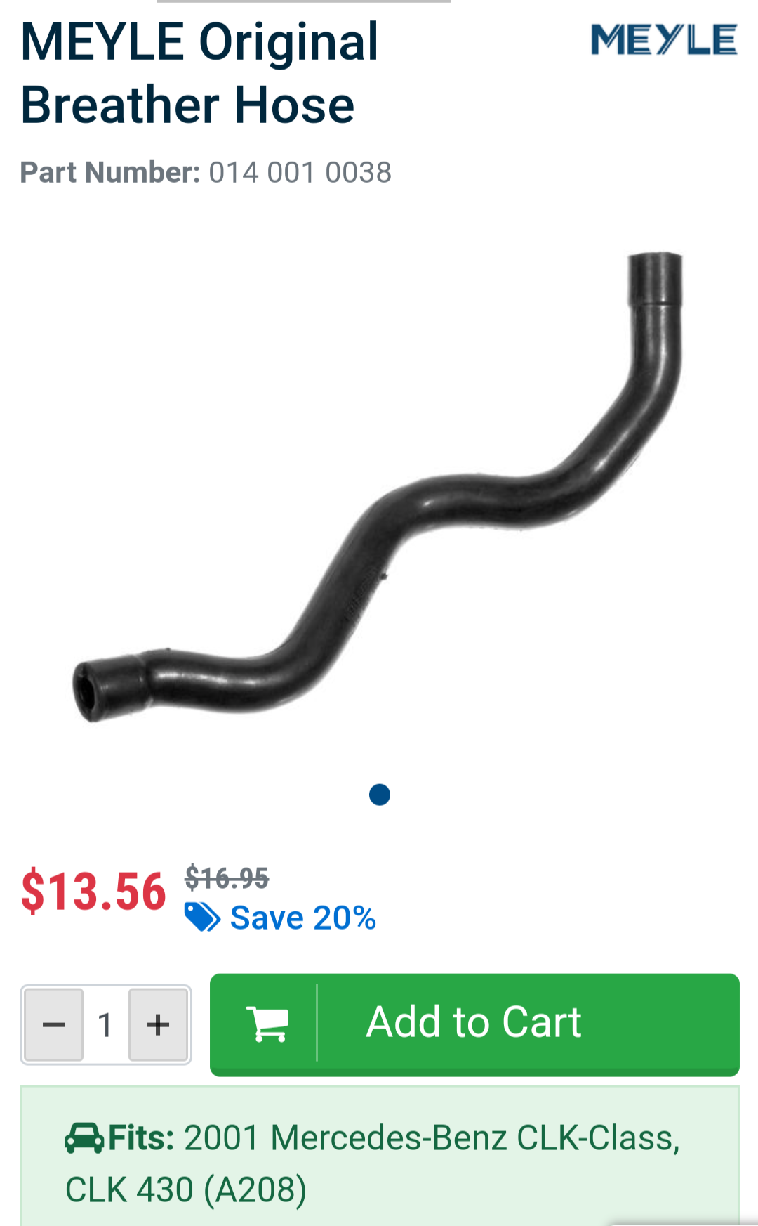

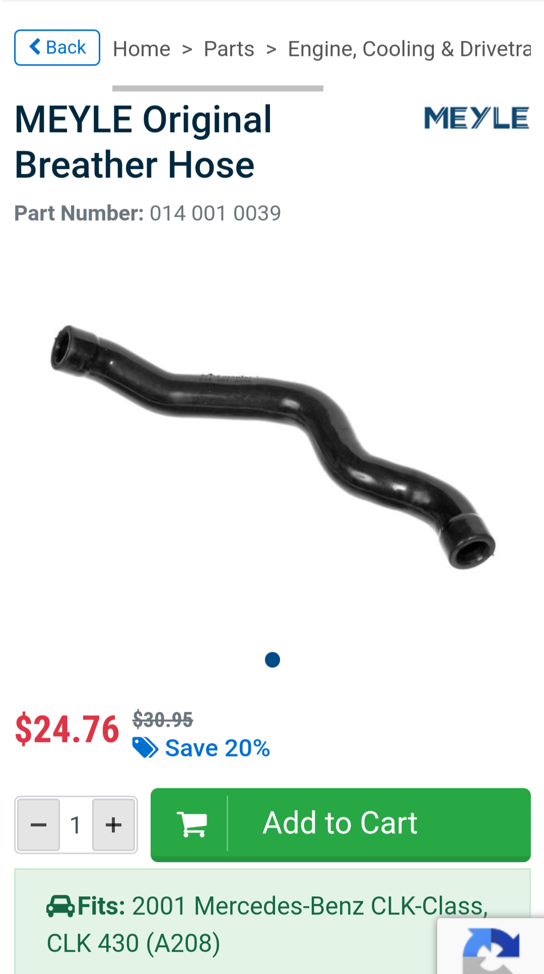

Would either of you know the part numbers for the plastic breather tubes?

The prices are Aus $ from a company called Sparesbox

Which hoses? What LateLife Crisis posted. The hoses that are most likely to need to be replaced are the two that actually attach to the metal breather covers since those are most subject to engine heat. At least that was my experience.

Thank you for taking the time @LateLife Crisis . With those part numbers I should be able to source the same in the UK.
