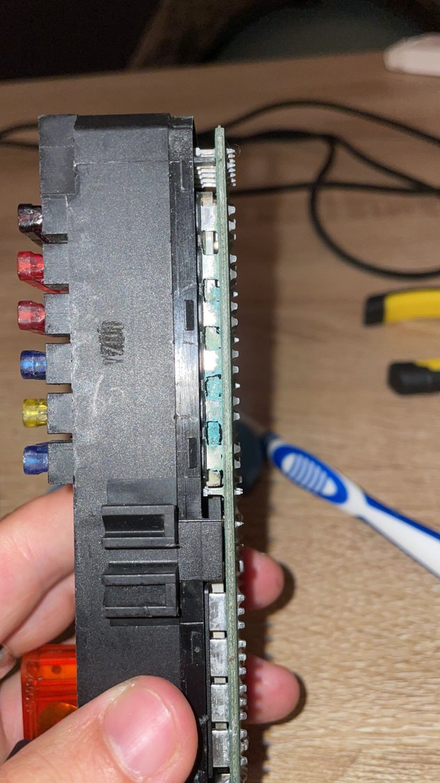

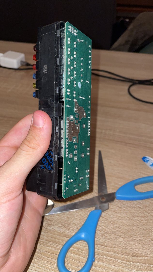

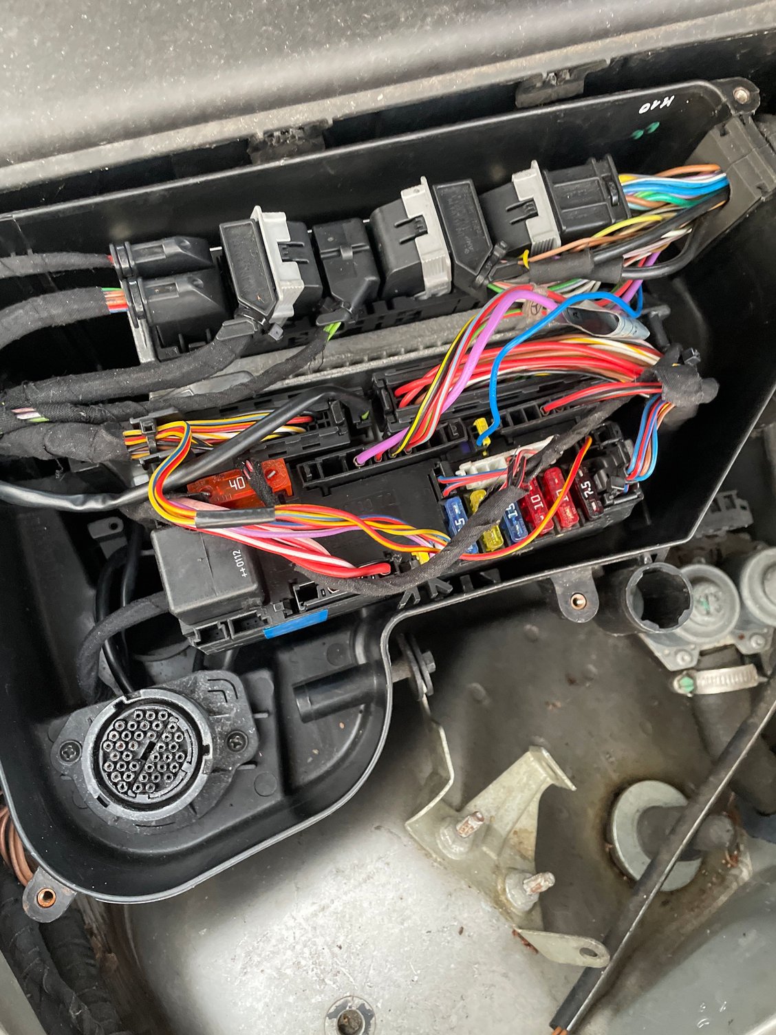

I heard about the K40 relay that can go wrong at some point in the life of those cars.
i pulled what i think is the K40 relay box ?
The solders look fine in my very unexperienced opinion, but the there seems to be blue/whiteish stuff on the circuits. Also 2 fuses have that sort of thing on one of the branches.
Is that the K40 box ? How to I remove the blue ( corrosion ? ) on the circuits ? Do I have to unsolder and resolder the circuit ?

Watch this video for help cleaning.

Thanks, definitely helps, I bought some circuit cleaner and it helped with the fuses and some of the circuit, but there's still more corrosion that is really thick and won't bulge. I bought some IPA which apparently helps more than circuit cleaner, I'll let the circuit soak in it a bit, maybe ?

Try vinegar

Thanks, but unfortunately still nothing. I replaced the 2 bad relays, replaced all the fuses, and cleaned the board with vinegar, then rinsed with IPA ( there's still a decent amount of corrosion, but I think I got rid of some ), let it dry, same symptoms.
Relays ( driver side, under the hood ) could have been the cause ( though they're apparently not ), but why would the corrosion from the K40 module suddenly cause issues.

Anyplace things connect it HAS to be shiny metal to shiny metal. If there is white, green, or grey/black stuff between metal, they don’t make contact.

Got it, I'll try to soak in in IPA or completely replace it then.
But out of curiosity, how did it work for so long with that corrosion and why did it suddenly stop working ?

Who knows. But I’m not saying this for sure is your problem.
But corrosion is always bad. Electricity through a board that is wet causes electrons to move the ions present. You effectively electroplate things to another place where they short a pin or transistor.
If you opened a laptop or desktop computer with corrosion inside, would you expect it to work correctly? It’s especially bad with small ICs with tiny little pins next to each other.

That corrosion looks terrible, I zoomed in and looked. What is really bad is if it connects two pieces that are next to each other.
The worst thing for electronics is when power runs through while wet.
Good news is you figured out “continuity” function of your voltmeter. 0 Ohms is indeed “these points are connected in a dead short”, which is good when they are meant to be. Like a fuse.
The beep is nice because you don’t need to look at the meter, you can just hear it. When testing fuses always try to test from connector, not just the fuse itself.
conversely, if you see two things near each other that are only connected by green or white crusties, and the meter says they have continuity when they shouldn’t you know to clean the bridge of corrosion until the meter says they aren’t connected anymore.
You have water intrusion issues. You will need to clean and sort that.
If carpet is wet anywhere, look under it. If a SAM got wet you will probably have to replace it. Keep hunting.
