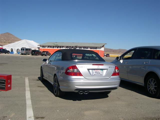

MBUSA brought several cars to Willow Springs Raceway last month. The new 550 is much faster than the outgoing 500. The two drive trains aren't even close. The '07 550 makes more power throughout the entire rev range. I can't compare it to the CLK55 because it's been two years since I've driven one on the big track at Willow.
MBUSA also brought a CLK63. Even as a convertible, the new 63 is substantially faster than the last CLK55 I drove. With more power and much better braking, compared to the CLK55, the CLK63 redefines fast.
