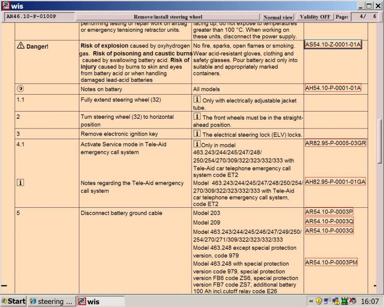

a) removing the airbag
OK - here goes. I'll post in 2 stages:
b) removing the steering wheel
Read all the instructions - not all apply to your W209. Also, I do not always disconnect the battery when the WIS advises. In this case I think that I would - even though you then have to 'normalise' windows, steering, sunroof, etc, when you re-connect it.
Note the torque for the steering wheel nut. The 2 bolts under the wheel holding the airbag are torx type.
Attached Thumbnails steering wheel-w209-airbag1.jpg   steering wheel-w209-airbag2.jpg   steering wheel-w209-airbag3.jpg

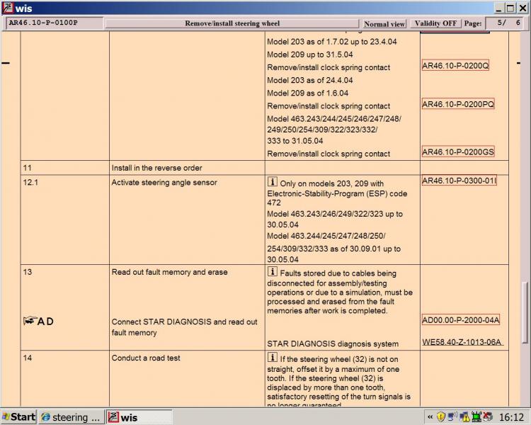

You may need some assistance to remove the center nut, while holding the steering wheel steady.
Attached Thumbnails steering wheel-w209-sw-1.jpg   steering wheel-w209-sw-2.jpg   steering wheel-w209-sw-3.jpg   steering wheel-w209-sw-4.jpg   steering wheel-w209-sw-5.jpg

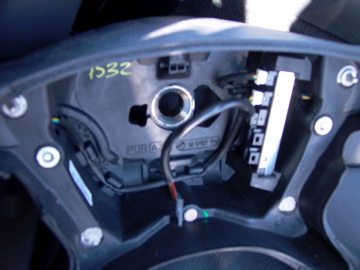

Ok I uploaded some pics of what to expect when you pull the wheel in a W209. I swapped from a button equipped wheel to a paddle equipped wheel. The pics should be pretty self explanatory. Notice the small holes on the back side of the wheel. this is there the torx bolts are that release the airbag. You will need a T shaped torx to get these out easily. Also a big honkin Allen head to remove the wheel itself. If you are swapping a wheel with buttons its easy. If you want to add paddles or buttons and did not have them good luck!. The silver bar on the right side of the inside of the wheel is where all the controls for electronics plug in. DO NOT remove the clock spring under the wheel. I also did not pull the battery. As long as the key is not in the ignition the air bag won't fire. Plese see my extensive writeup on benzworld for step by step installation including a tool list etc. The wheel i put in is a factory AMG wheel with Alcantara. It is super nice and I got it brand new shipped from Sweeden for about $400 something. A fantastic deal at the time. The guy sells this wheel today for 699 plus 60 shipping.
