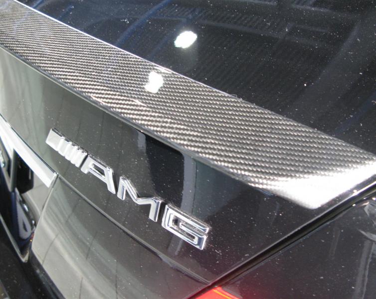

Thought you might enjoy a pic. I snapped at the dealer (on a C63) to take your mind off such matters.
Old Apr 21, 2010 | 10:45 PM
Mka77's Avatar
Joined: Jun 2009
Posts: 1,314
From: Witness Protection Program
06 CLK350 -SOLD! 2010 Cadillac SRX Premium Turbo
Good call.
