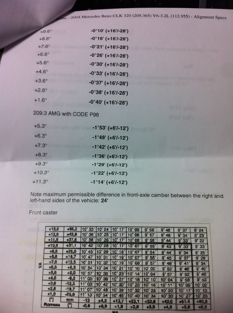

Alignment Spec Sheet Help
While the car was in the shop I had a 4 wheel alignment done. I have the spec sheet here, but I'm kind of lost reading it. I would appreciate if anybody out there can help me making sense of this. Thanks

That's crazy!! But everything looks fine. I can't believe they wouldn't just give you a normal printout. Did they say whether or not it was in spec?

They said everything was good. I was just curious about all the different readings. I usually see these spec sheets much more concise detailing each corner.

It looks like they took different measurments at different suspension compression points.

+1
Those are MB’s preferred alignment specifications, not your actual settings/readings.
Because changing front and rear ride substantially affects camber, caster and toe,
MB lists different angles to account for the changes that invariably occur as the suspension cycles through its travel.
Note the factory specifications are not necessarily ideal for fully exploiting available grip and/or maximizing potential tire life.
Savvy enthusiasts will often alter them to better suit their specific purposes.
