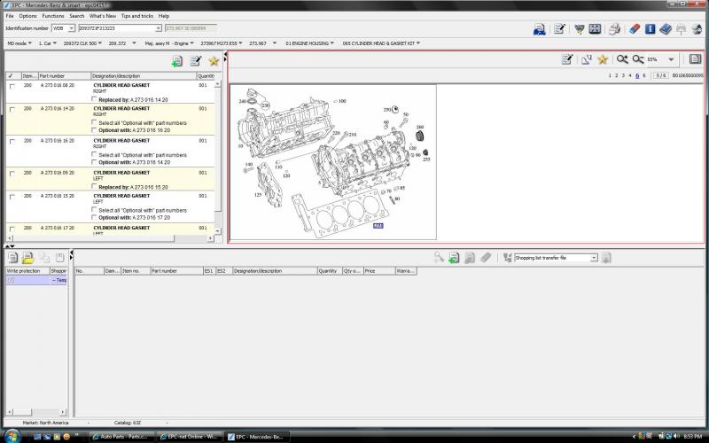

i will look tonight at the epc and get you the part # as well as the price off parts dot com

i think your right don't see any covers...take it to an indy or the dealership if you can't figure it out...
Attached Thumbnails 2007 clk550 with 55K leaking valve cover-no-valve-covers.jpg
