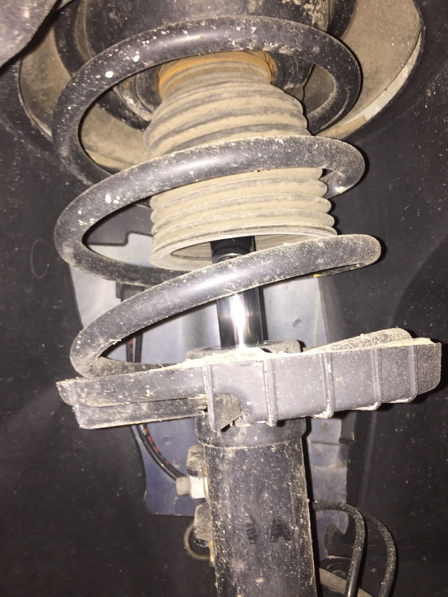

Thanks for all the advice guys. Just installed my new wheels and tires and got a fresh alignment to boot.
Excuse my ignorance, but aren't these coil-overs?

No, they're not coil overs.
No they're not coil overs.

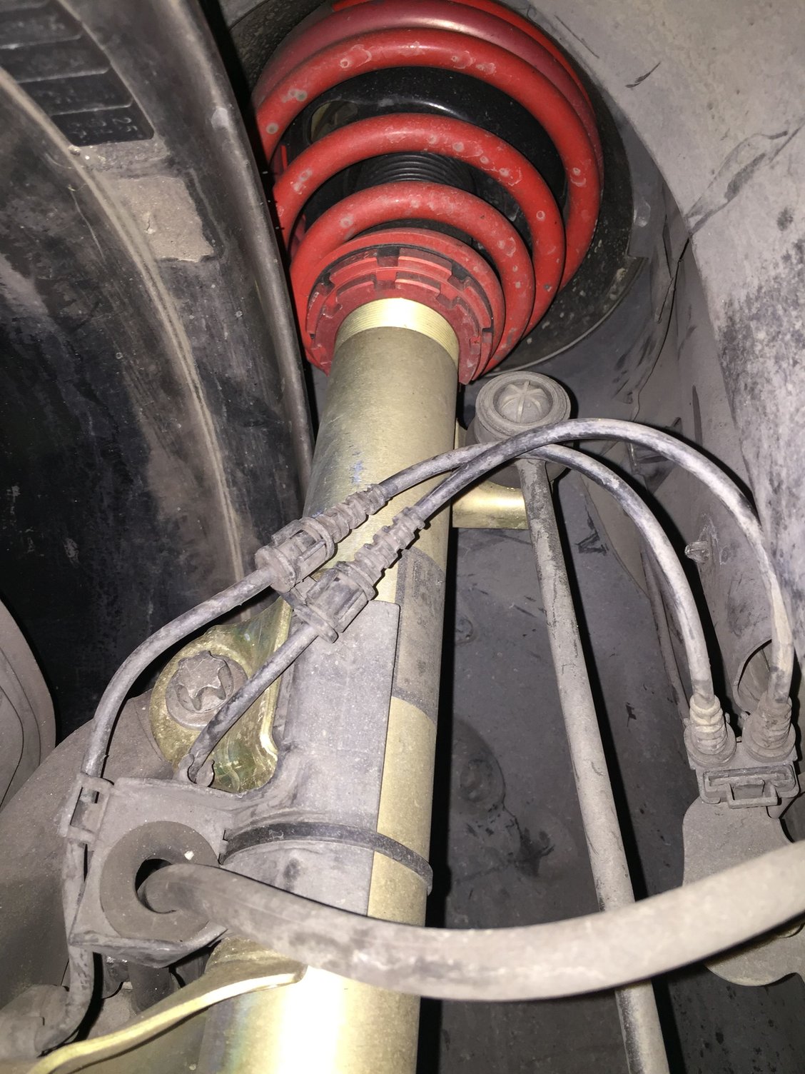

Coil overs
Here's mine.
H&R coil overs

Originally Posted by vinsuz
I'm not sure I see the difference.
your picture are springs. they provide one ride height.
coil overs are springs but with an adjustable "seat" that allows you to adjust the ride height. so in the coil over pic there's a red metal piece the spring sits on that can rotate on threads compressing the spring to whatever height you want.

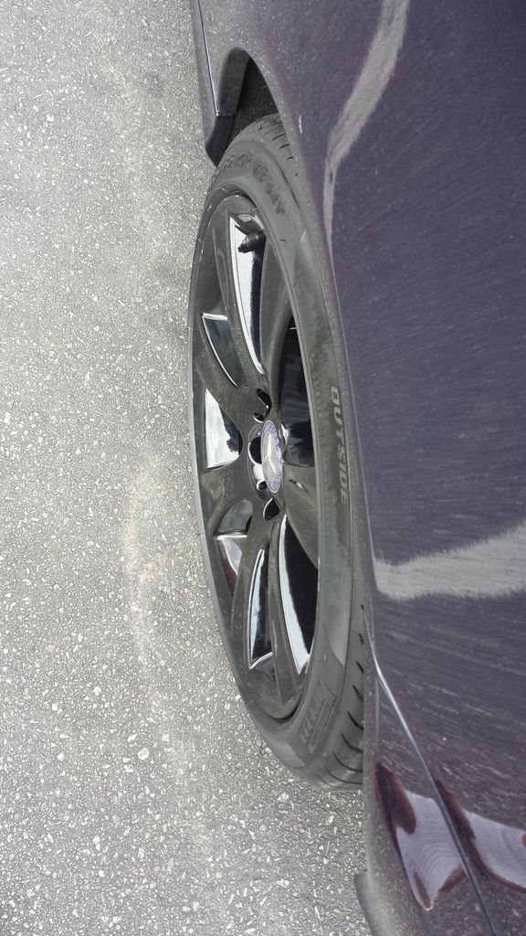

Hello all,
I bought this CLK recently. But I don't like the wheels that much. As I would like to see what you guys think. If you had these wheels shown on the picture below, what would you do? The info is as follows.
A. Post a pic of your car - see below
B. Post wheel: Size, Width, Offset. - 225/40ZR18 front, 255/35ZR18 back
C. Tire make/size - Hankook V12 EVO
D. If using spacers-size and manufacturer. Shortened lug bolts or not.- no idea
E. If lowered- what manufacturer and how low. Also, if using a camber kit or not. - not lowered
F. Any issues with your setup or warnings about previous setups - no issues

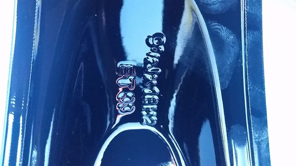

Front wheel
I recently bent and cracked a front wheel. It was 19x8.5 32ET. The wheels are discontinued and I don't feel comfortable with a repaired crack in the barrel. I was able to find the same wheel in a different size. Would these fit my 550. 19x9.5 ET45. I would add a 10 mm spacer. Would these clear for the fender? Keeping the 235/35/19.
