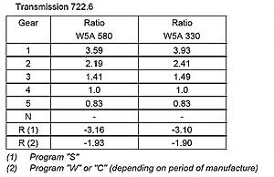

For mis3

Thanks, Ruck.
I understand now. The "C" setting starts the car in 2nd gear. It applies to reverse also, R2.
I will do it later to make sure the new fluid runs through R2.
