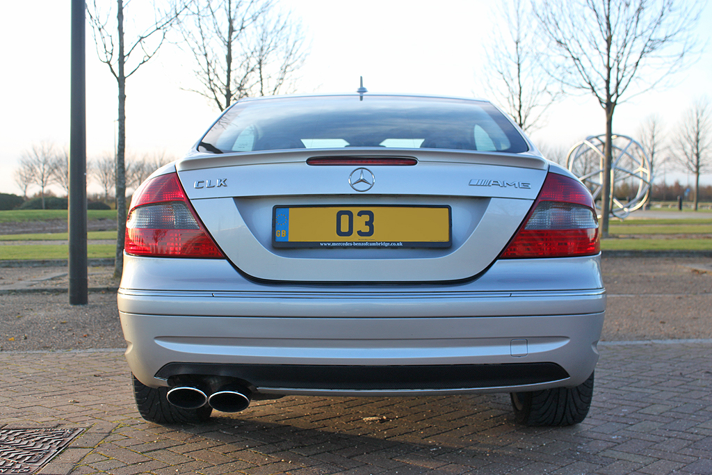

November 2012

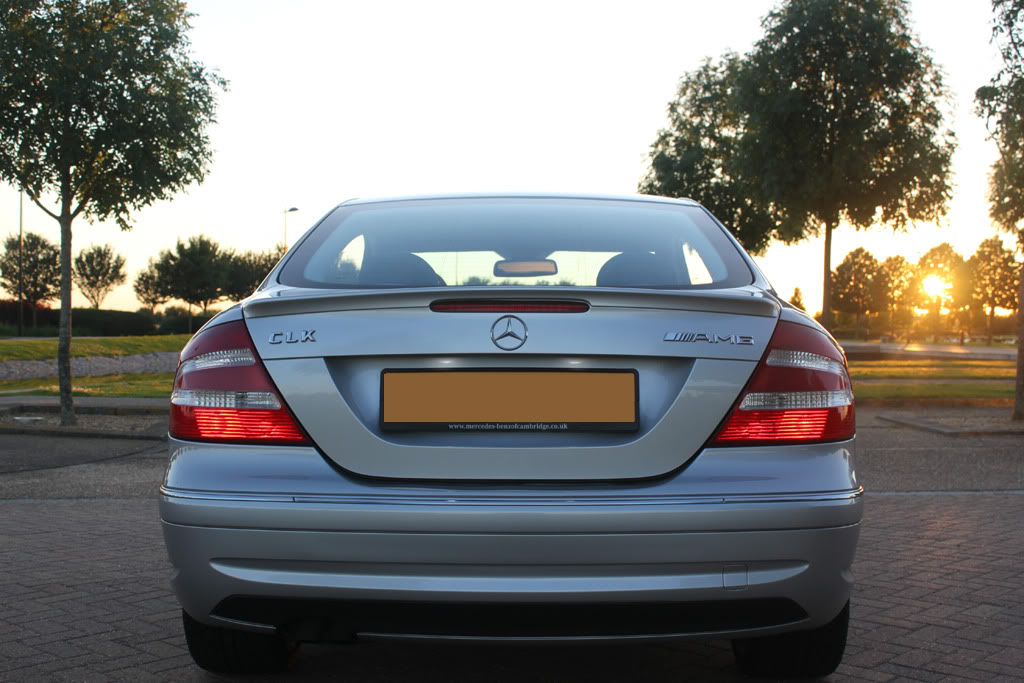

Mod 8) CLK55 AMG Rear Box:
Another 2x Tips will be added in the future for the Quad tail pipe set up

@BBW: did you have to cut your bumper wider where the exhaust sits? looking good! the aerial is one I haven't seen done before... nice work, we might see that a bit more hopefully!
Yep, had to cut a huge amount off, they are very wide compared to the C43 AMG tips on my last car.
Before:
After:

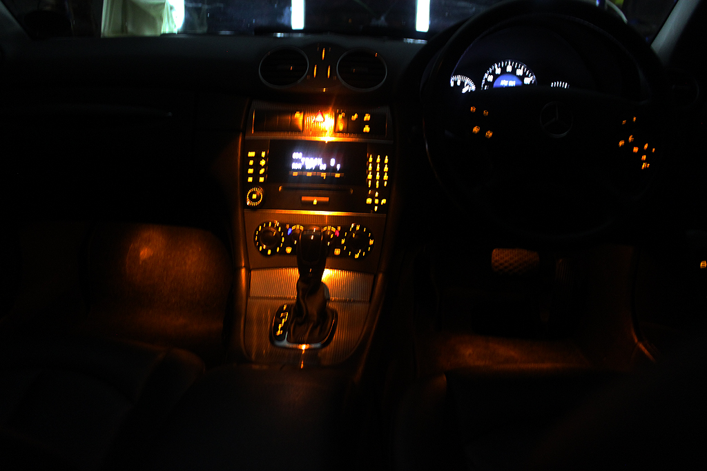

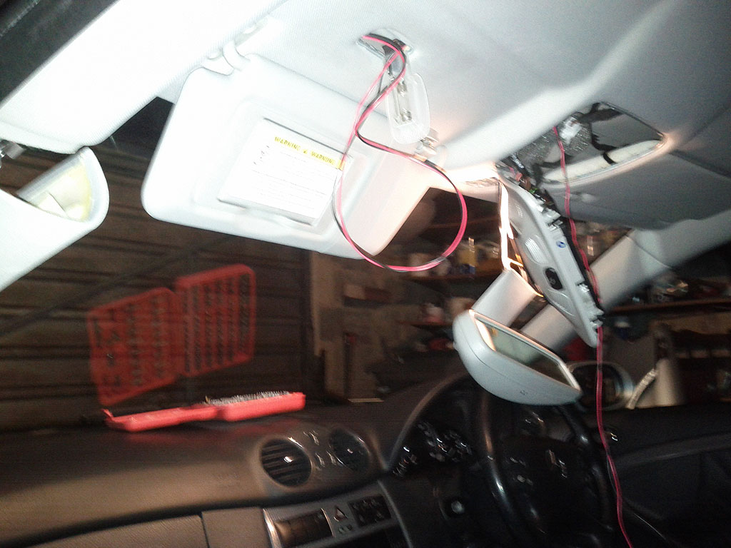

Couple of pictures of my ambient interior lighting mods, im currently added 2x per front footwell and also one at the bottom of my rear view mirror:
I hope to have it all finished this weekend if its not stupidly cold again

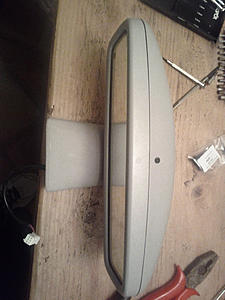

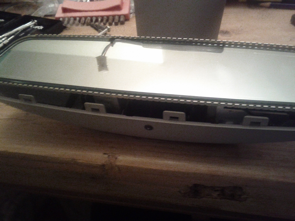

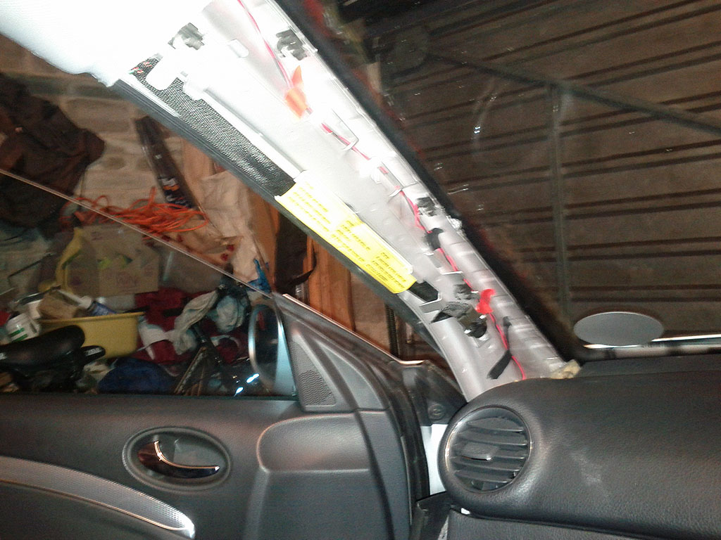

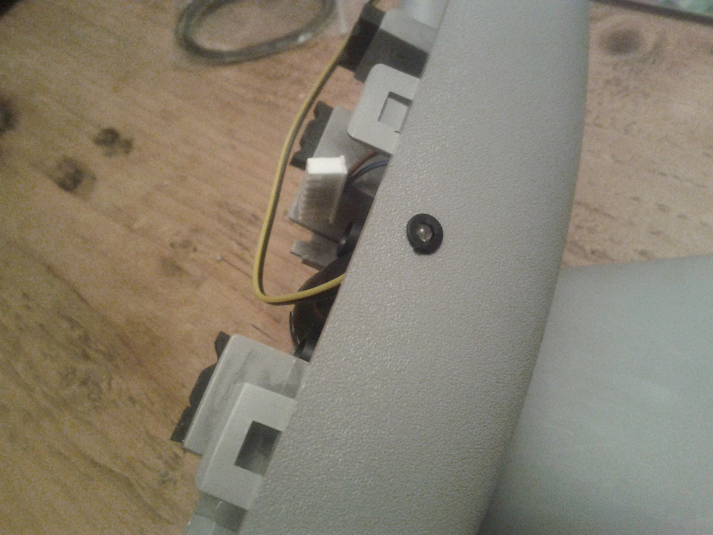

Had a go at wiring up the RVM light this afternoon, wired it upto the factory fitted ashtray ambient light via the A-Pillar:
Careful to position the wiring away from the curtain roof airbag:
And finally a shot of the actual light on, this was before I applied some sandpaper to the LED to create a diffused light effect so its not as bright as this shot implys:
Once I have finished the footwell lights I will take some decent pictures with my SLR camera that can pick up low light levels a hell of alot better than my phone camera!

Best picture I could managed before the battery ran out. They arent as bright as this in real life (ive brighten it in PS) but it does give you a good idea of what I have done:
2x LEDs per footwell, and one at the bottom of the RVM

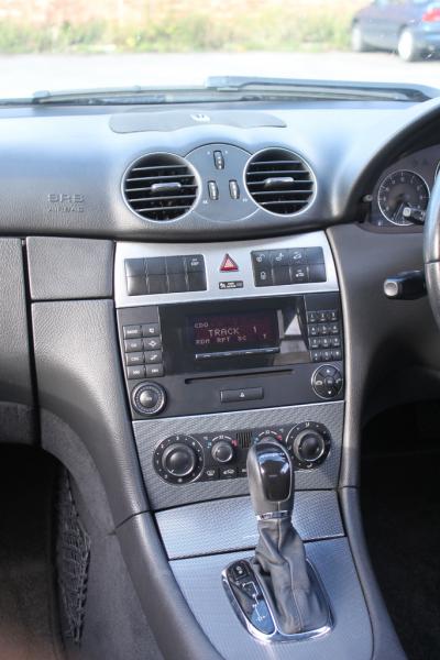

Originally Posted by BBW
Complete Dashboard facelift conversion:
Before with Audio 10 and pre-facelift switchgear:
After Audio 20 and facelift switchgear & heater controls:
(I know the upper trim doesnt match, but I cant find it on eBay )
I am interested to hear more about this mod. I am planning on doing it myself but the radio etc doesn't just plug in and work or does it? I had comand before I switched to an aftermarket dynavin unit. The top control unit and climate control are straight swap I assume? what did you do to get the radio working? have just ordered a face lift cage to hold everything in place and keen to start collecting all the bits.
For your previous post, I might be wrong, but I think VSIX actually backed you up instead of giving you *****. I think I might have been overreacting a bit towards the badge as its your own car in the end. I understand you aren't trying to convince anyone your car is a true AMG.
Keep the mods coming please! I'm really enjoying what you do to your car!
Attached Thumbnails My 2003 CLK270 CDI - Modding Project-help1.jpg   My 2003 CLK270 CDI - Modding Project-finaldash2.jpg   My 2003 CLK270 CDI - Modding Project-finaldash0.jpg   My 2003 CLK270 CDI - Modding Project-finaldash1.jpg
