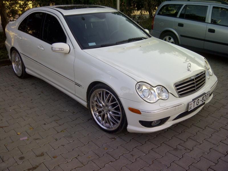

Just one more question:
Error codes P0016, P0017 - Are these codes (problems) appears on 2005 c230 kompressor engines also? or it is common problem on m272 engines only?
Miro
Old Nov 27, 2013 | 10:49 PM
  #394
Rudeney's Avatar
MBworld Guru
Joined: Dec 2009
Posts: 10,782
Likes: 1,011
NO LONGER ACTIVE
I don't believe you will ever see P00016 or P0017 on an M271 engine (1.8l I4 Supercharged int he MY2005 C230). The balance shaft issue is definitely not a problem with the C230 Kompressor - it only affects the V6 M272 and V8 M273 engines.
Old Nov 28, 2013 | 12:15 AM
  #395
howdymiro's Avatar
Joined: Oct 2010
Posts: 28
From: Batumi, Georgia
07. C230 2.5l
thanks you very much Rudeney.
Great news for me. Say truly i have no time for Headaches, i'll just sell my car with a cheaper price and will get 2005 C230 Kompressor.
I hope M271 engine is more reliable and will not give as big problems as M272.. Am i true?
Attached Thumbnails Please check my VIN for Balance shaft issue?-img-20131124-00288.jpg   Please check my VIN for Balance shaft issue?-img-20131124-00286.jpg
