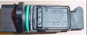

I took out the maf myself based on a guide I found and cleaned it with maf cleaner. While cleaning, I noticed a brown rubber like square border type ring on the maf was cracked. Can this cause the symptom (and not be enough to cause error codes or cel?)
Also, any suggestions on getting this shaking fixed? I've read it could be build up in the cylinders, spark plugs, coils, maf.... Also, there was shaking before but that was because of bent wheels and it went away after I got the wheels straigtened. I don't think this is tires/wheels because sometimes it will shake before the car even moves.
BTW, I attached a picture of a maf that shows the brown rubbel seal ring thing. Mine would look the same but cracked.

There is an excellent chance that it is the MAF

Sometimes a bad MAF sensor won't throw codes. If you have rough idle and bad MPG, I think it may point to the MAF. That seal should not be cracked. In fact, I can't imagine what caused it to crack - it shouldn't get hot or be exposed to any chemicals that would deteriorate it. It's going to cost several hundred dollars, but I think I might go ahead and replace the MAF sensor to see if it helps.
