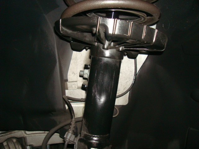

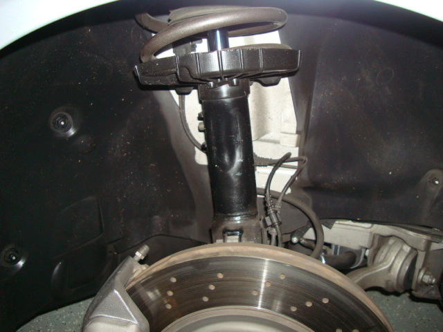

Good luck on getting your suspension repaired. I will be replacing my shocks/strut with Bilsteins. The car is lowered with H&R springs but with original OE shocks. The ride quality is intermittently awful; can be quite jarring with the H&R sways installed.
While I had the wheels off I noticed a dent in both front shocks. I don't think this is a design feature........ I will replace them anyway but thought I would provide pics of the both the driver and passenger side fronts.

I think that dent is normal. I have it on my car and it was on my R171 SLK.
It's so you have room to fit wider wheels... Well that's how I figured it out lol.
Thanks Disco. That makes sense..... It would be awful if we had to run on 215s....
Now, I will not worry about them too much and install the Bilsteins according to my "sink money into the toy" schedule (2-3 months).

That dent is normal - both my CLK and C have it on their struts. Discoduck is probably correct - it's to add clearance for the wheels. It could also be for some stiffening, since this strut carries a lot of weight and torsional forces.
