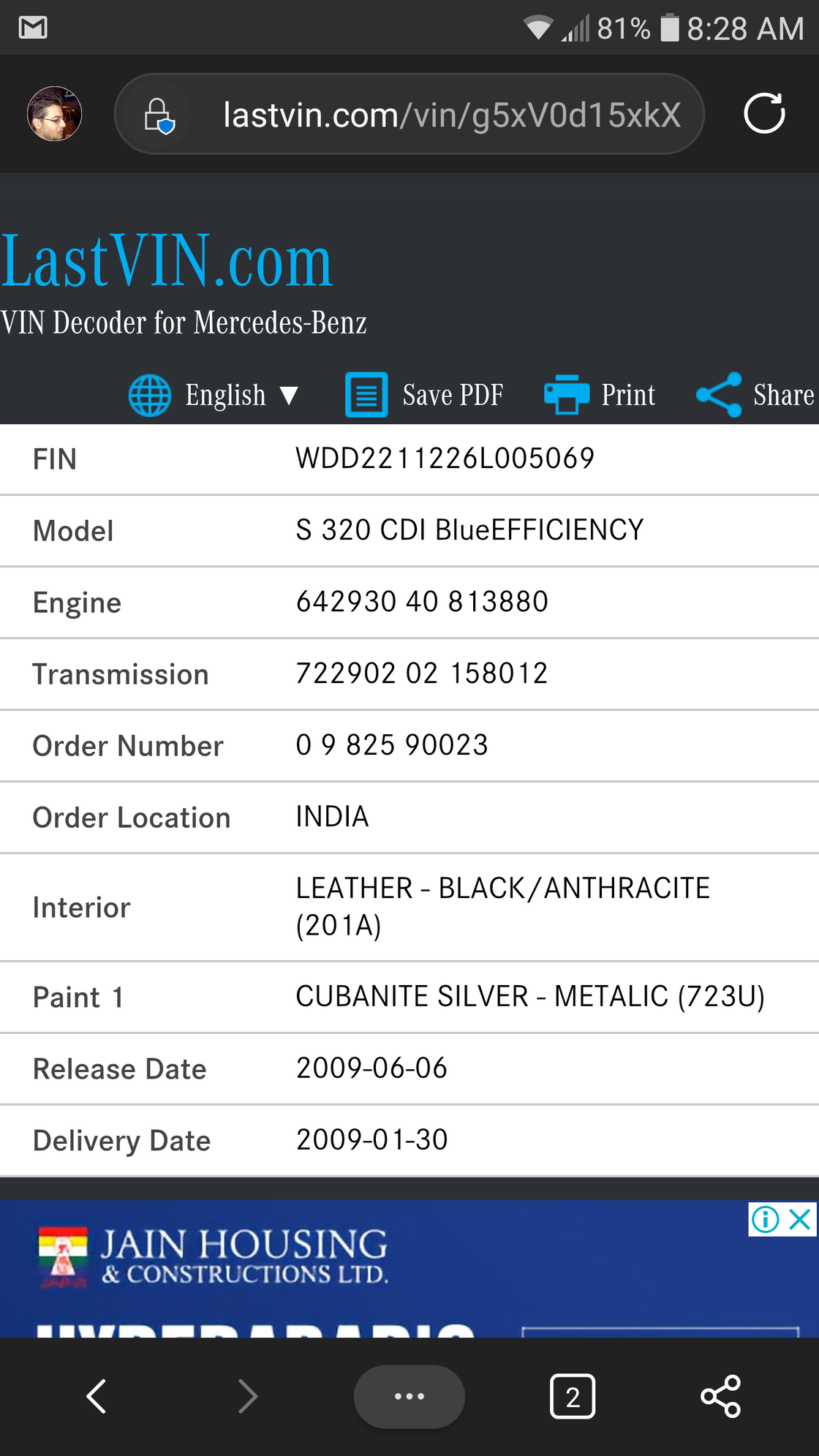

Transmission 722.90202, does my Torque Converter have a drain plug/bolt?
I'm nearing 97,000 Kilometer on the Odometer, and MB India has suggested we do a transmission flush, and filter replacement. Does this transmission 722.90202 have a Torque Converter drain? Please advise, our service department here is lacking knowledge.
Old Jan 8, 2021 | 08:36 PM
E63007's Avatar
Joined: Nov 2017
Posts: 369
Likes: 53
07' E63
I just did a rear Main Seal and, while I was at it, I ended up removing the Valve Body and gave that a full cleaning! As for the TC drain, yes all you have to do is spin the Crank with a rachet from underneath as you look for the TC Drain screw. It's a small hex head and on my 2007 AMG E63 when I inserted the hex bit, it was obstructed by the Tranny Oil Hoses that go to and from the Tranny, so it required a basic removal of both hoses. Since I was doing the Rear Main which requires removing the Tanny anyway, those hoses were removed in order to drop the Tranny! Once removed, the drain plug for the Tranny was easily removed with the hex bit. Just be sure to pull down so as not to cause the flywheel to spin while you do it otherwise you'll have to reposition it with the Crank Rachet. Since I had the tranny fully removed, I opted to fill up the Torque Converter manually by using a very small funnel to fill the TC up with new, in my case LiquiMoly RED ATF Tranny Fluid. Note that when doing so, assuming the drain hole is aimed upwards in order to fill it, once it reached halfway full any fluid poured in will come out via the Center of the TC!! I had wondered how the TC is cycled with fluid and doing this process answered my question!! As for a weep hole on the inner side of the TC or a similar one on the Transmission Drive Shaft, I did not see that. But I found that the TC had to be installed/Seated in an exact position clockwise in order to fully retract towards the interior body of the Tranny, otherwise it would have remained too far out on the shaft and would not have been able to be installed! Obviously since it has to be installed a specific way, I can only deduct that there is some built-in weephole that is matched somewhere on the shaft!! I took a little fiddling with but I finally got it there!
