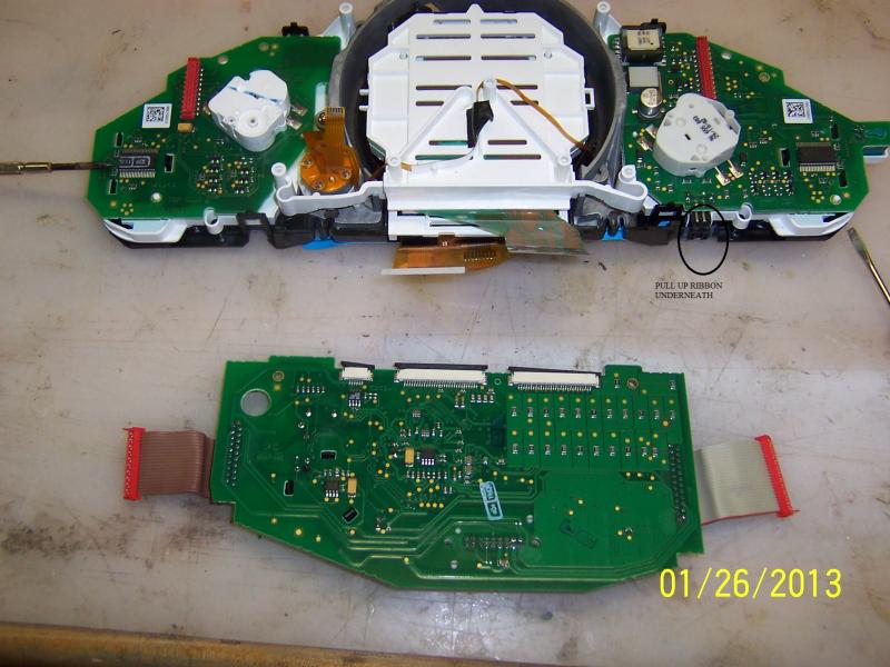

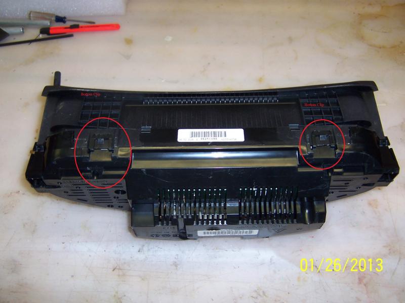

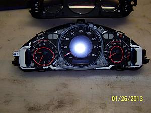

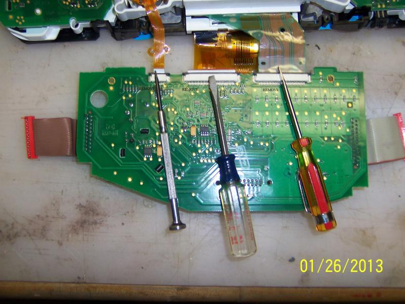

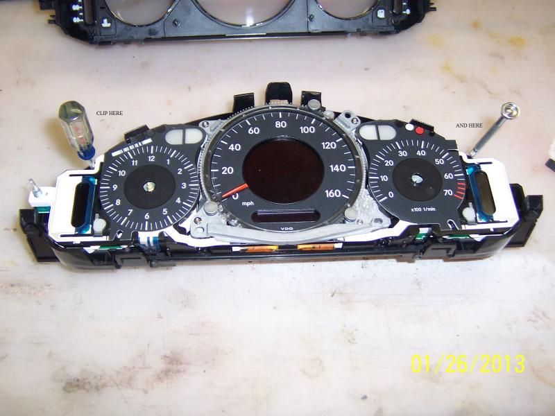

Jan 26, 2013 | 02:33 PM
Andy,
Here ya go.
05 CLK500 w the 06 CLK500 Cluster !!!-100_6413.jpg   05 CLK500 w the 06 CLK500 Cluster !!!-100_6414.jpg   05 CLK500 w the 06 CLK500 Cluster !!!-100_6415.jpg   05 CLK500 w the 06 CLK500 Cluster !!!-100_6416.jpg   05 CLK500 w the 06 CLK500 Cluster !!!-100_6417.jpg
Reply 0

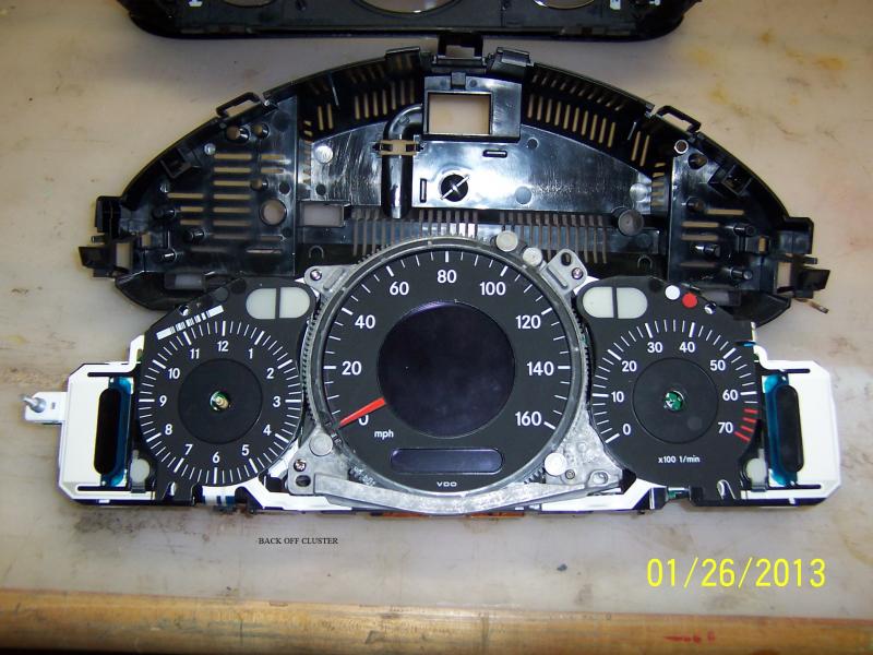

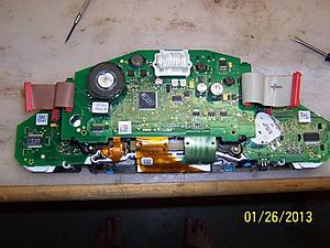

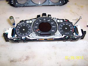

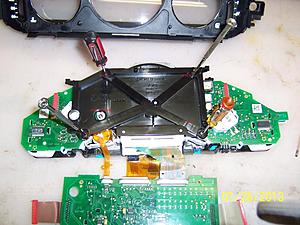

Jan 26, 2013 | 02:35 PM
MORE
05 CLK500 w the 06 CLK500 Cluster !!!-100_6419.jpg   05 CLK500 w the 06 CLK500 Cluster !!!-100_6420.jpg   05 CLK500 w the 06 CLK500 Cluster !!!-100_6421.jpg   05 CLK500 w the 06 CLK500 Cluster !!!-100_6422.jpg   05 CLK500 w the 06 CLK500 Cluster !!!-100_6423.jpg
Reply 0

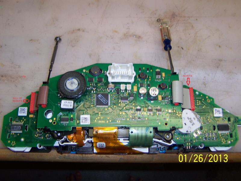

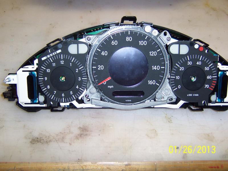

Jan 26, 2013 | 02:36 PM
One more hope it helps if you have questions ask..I am off to go play poker..
Heres a link to Photopucket
http://s1251.photobucket.com/albums/...Rally/Cluster/
Reply 0
Jan 26, 2013 | 02:38 PM
Thank You Sir ! I'll ask if i stuck and have fun lolz
