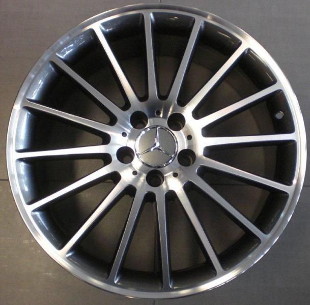

Hey guys,
Have just got bought a 209 CLK55 cabrio silver with grey roof,
cant decide on which wheels, have narrowed it down to these two styles,
what you think? or any other suggestions?

I'm a fan of the large and shiny lips on wheels and of multi-spoke wheels; so in a narrow victory, I would choose #2.

C63 just my opinion but the fake beadlock on rims looks retarded on cars could be because i used to offroad so i associate it with trucks but i just enjoy a nice clean rim just my 2 cents

The first one looks awesome. That would be my pick.

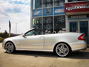

Put the euro 63 wheels on, had to use spacers to clear front caliper.
Caused vibration above 110kmh , so gonna change to the c63 wheels
Some pics anyway

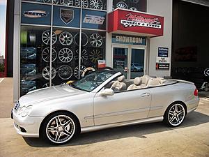

Another

Wheels look great! Was the spacer hub centric? You should not have any vibration from the spacer. The hole in the spacer should be the same size as on your hub. The front hub has plenty of room to run a spacer without needing the spacer itself have a lip on it to be hub centric. On the back anything more than a 3mm spacer requires one with the lip.

no they were not hub centric, a 5mm shim was used, I have changed the wheels to the c63 style as i would rather not use spacers,
