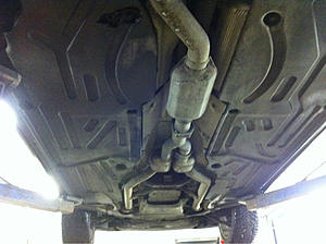

After experiencing potential cat failure (unstable idle, and foul smell after strong acceleration) on clk500 wanted to get rid off the cats. But hey always wanted to have a quad system in place, so thought why not cut the cats and the rest and replace it with straight pipe system high flow resonator and quad tail pipes. So, went to the garage this afternoon and handed in my beauty to a hippy looking exhaust guy
Will update soon with sound video and my opinion on sound and power gain!
So far this is the progress guys

I think you're about to "crank up some volume".

Fatz i really hope so

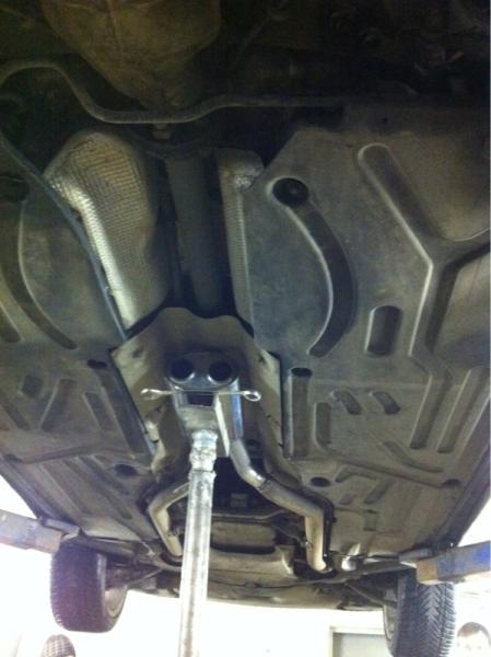

Almost done, just final adjustments, video coming shortley

Hey did you get the black series sway bar or did you just angle the pipe for the right side away from the sway bar?
From the pic it seems that the right side is about 1" lower than the left with 2 45 degree bends to avoid the lower section of the sway bar. Looks very clean. If the shop used has the capability, a mandrel, more smooth, bend could be used.
Looks like plenty of room along the tire well to. That gap along the spare well is 4"+ inches.
I may have that section around the sway bar reworked on mine next summer to resemble this.
Hey mate, the guy at the workshop worked around it, the clearance is great so was no need to change the sway bar, its neatly done and didnt cost an arm and a leg. Still cant get enough of driving it, its a total transformation. Really happy with it!
How did you get yours done?

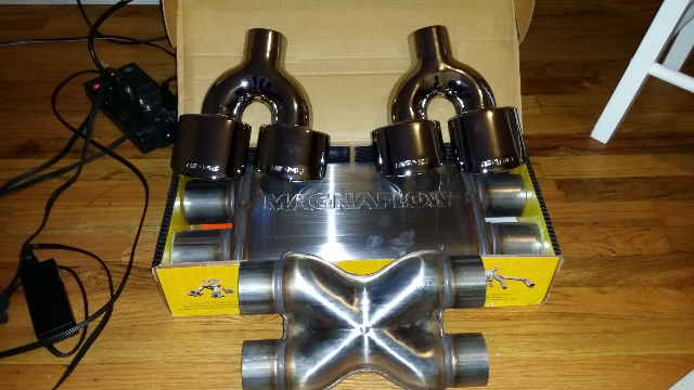

I'll be joining the quad crew soon. The last part came in.. AMG tips.
Secondary Cat Resonator and Backbox delete on CLK500-forumrunner_20140128_181905.png
Still debating on the deleting the 2nd cat or replacing with vibrant resenator
Attachment 277519
Hey congrats on your purchase mate! looks like a very nice and neat kit! How much did the tips set you back?? With the cat's, it depends what you want from the car, they do restrict the flow and eat away a fair amount of horses, so getting rid of them will definitely ease the flow and crank up some volume, but having a vibrant resonator in place might give you a deeper gurgling sound. Suppose just have to experiment a little with it and see what you like. Upload some photos/video once you do it, would be nice to see the setup and itching to hear what it would sound like. Good luck mate!
