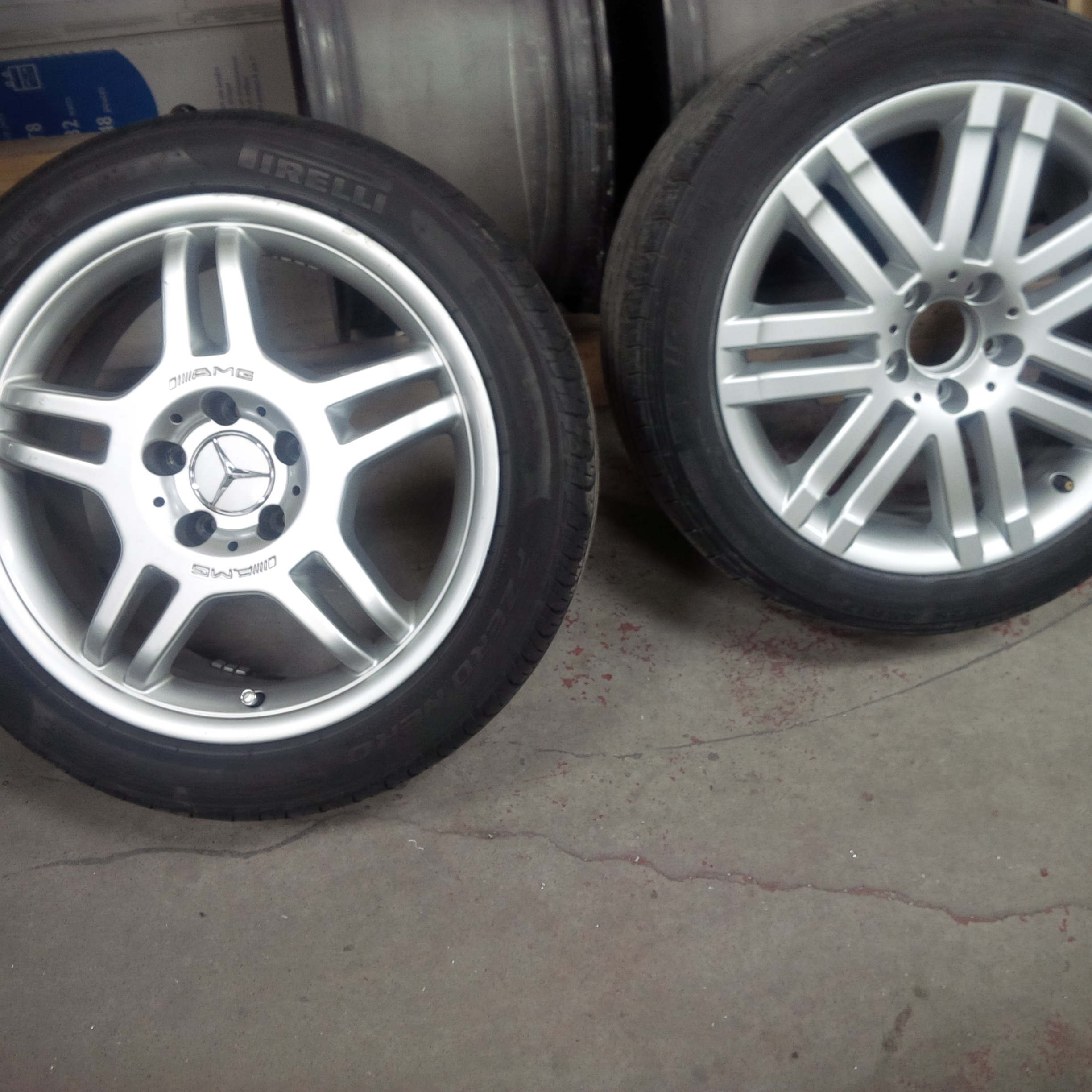

I was driving along and I felt something funny with the ride. I looked and the front left was completely flat. I replaced it with the spare tire and made it home.
I went to the tire store and the guy showed methat my wheel was cracked in the inside rim. They referred me to a wheel repair shop and they repaired the wheel (welding, straightening). When I picked up the wheel, I could see a bump at the weld point from the inside. Surprisingly, the car drives great and in the last few days, I went up to 100 mph a few times on the highway.
I still don't know if the wheel cracked first or the tire went flat first.
I googled cracked wheels and like everything else, there are many opinions on the net. Some people said the wheel will crack again.
I am thinking maybe I should get a new wheel but it's hard to find these old wheels. Mine is the old AMG Type IV double-spoke wheel as the C55, or C32 (left one in the picture). Where can I find these wheels? My local dealership can probably get it but it would be expensive.

If properly repaired should be fine.
Those are the old C32 style wheel not C55.

I remember they were from an AMG C Class not sure if they were from C32 or C55. Thanks for the clarifications.
Does someone know of the part number (17x7.5)?

Theae are not the same wheels. Mine is the early Type 4 with the unbroken circular centre. The spokes on my wheels are shorter than these. One visable differnece is my wheel has the word AMG both ablove and below the center cap.
Furthermore, these are 18-inch , mine is 17-inch.
