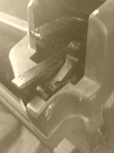

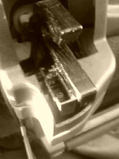

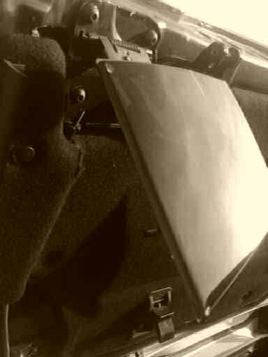

I gave my car to my friend to drive but he end up messing up my convertible.
He broked some component from the convertible part, i want to buy the broken part but i don't know the name of the part..kindly view the attached of the faulty part damaged by that stupid friend of my....please help me with the part number and where to buy them.
Please view the pictures you will see that the left switch is broken why the other pics is the right switch that is okay why the other pics is the right cover but the left cover is broken.....please help me i want to buy this part but i don't even know the name of the part.

I believe the switch is part number A2098201910. I am not sure what is broken on the flap - there are several parts to it.

Hello every one, i have the same problem on my clk w209 the back side of the roof get stuck on the opening and will not lift, this is after i change the line 22 of hydraulic roof, also i notice my switch it is broken like yours.. Did you find a solution?

Hi I manage to change the micro switch part number A2098201910 and all works perfect, time changing 20 minutes job done, thank you all for the information posted in MBWorld..
