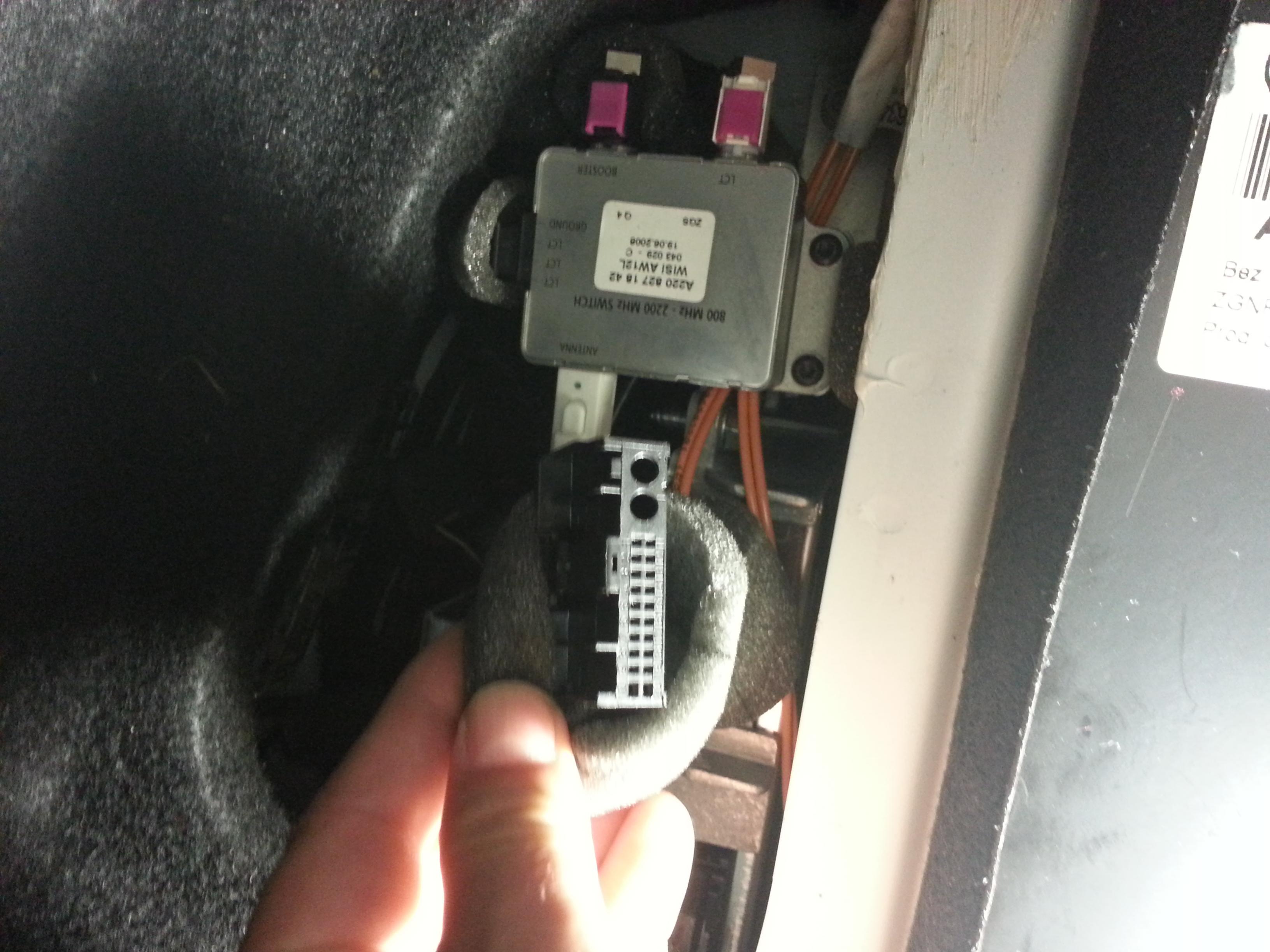

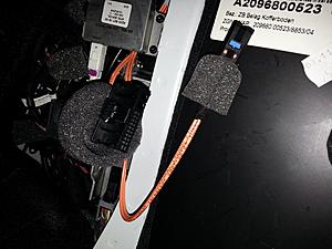

ok the module came today
now..there is a fiber optic connection by the harness ...i am not sure how to do it...does it need just coding to enable that fiber optic line?
radio works like that ..so.. any help?

Old Oct 6, 2014 | 09:48 PM
Rudeney's Avatar
MBworld Guru
Joined: Dec 2009
Posts: 10,782
Likes: 1,011
NO LONGER ACTIVE
The fiber optic system is a closed loop. If you find any "open" connectors, then they are not part of the loop. You will find some of these around the vehicle, used for options not installed. This is very hard to explain in text, and I don't have any good photos, but what you have to do is find a spot on the fiber where there is an inline splice. Remove the splice, then "borrow" an unused connector and put the two parts in there so you can plug into the VCM.

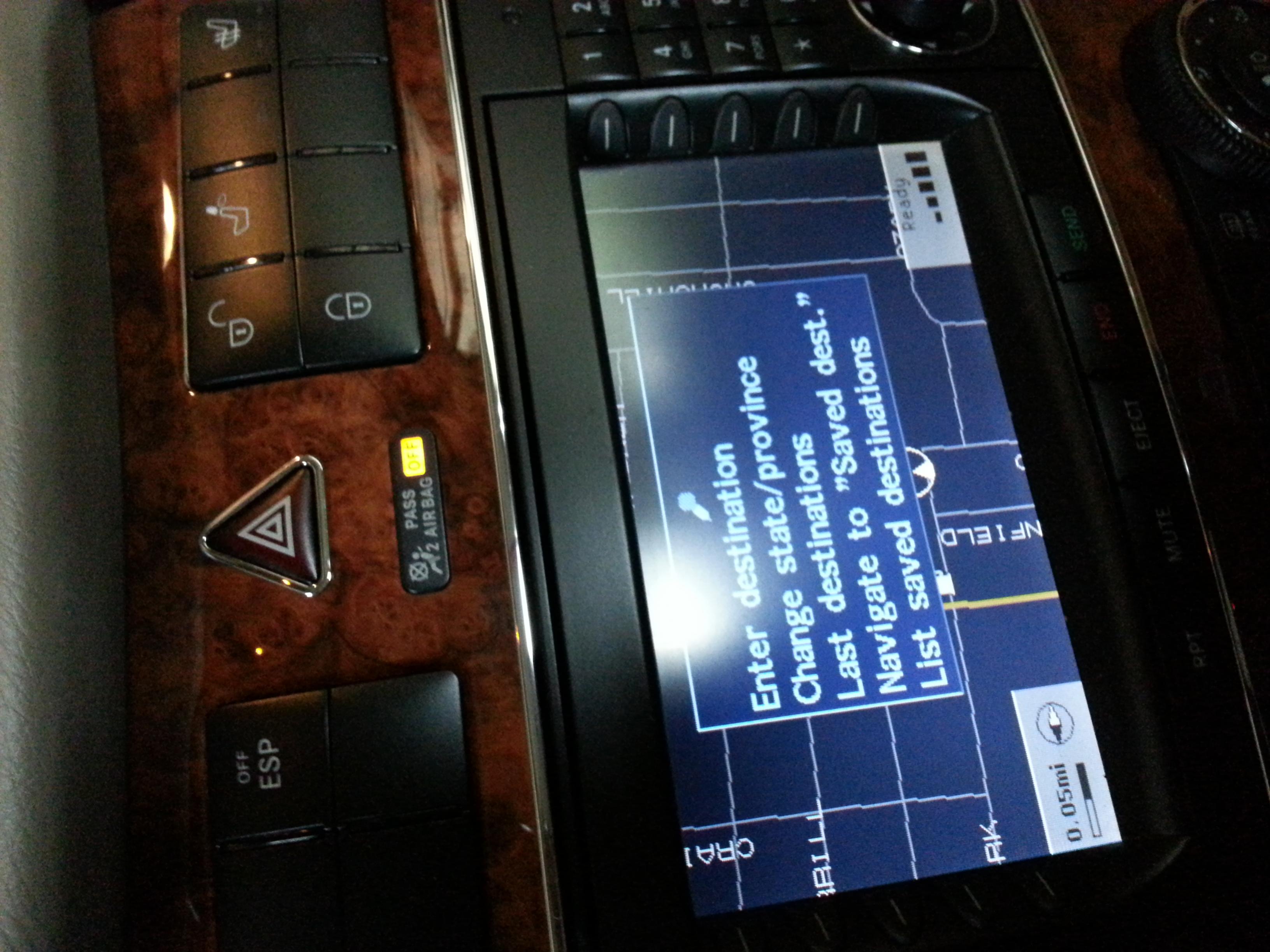

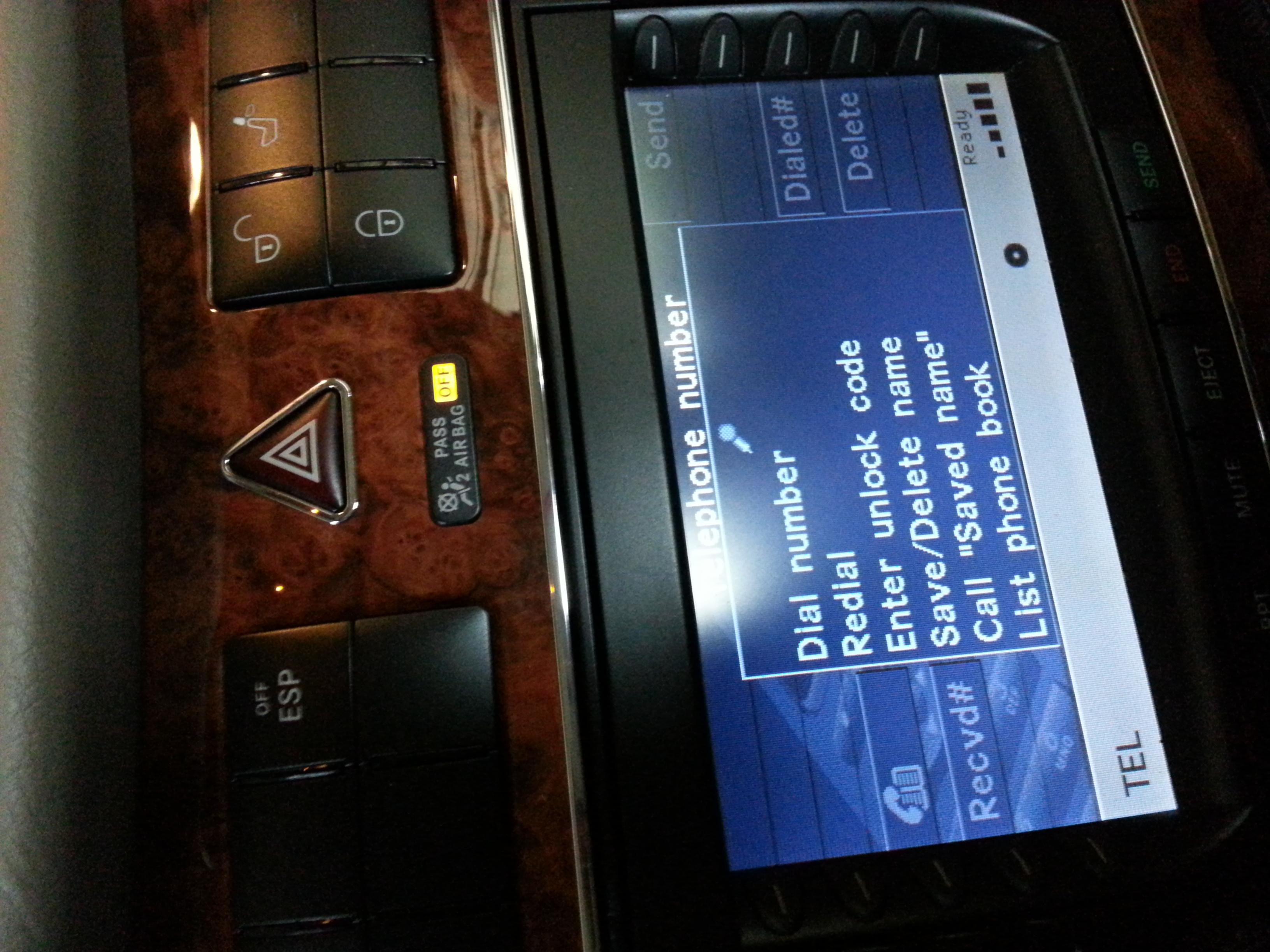

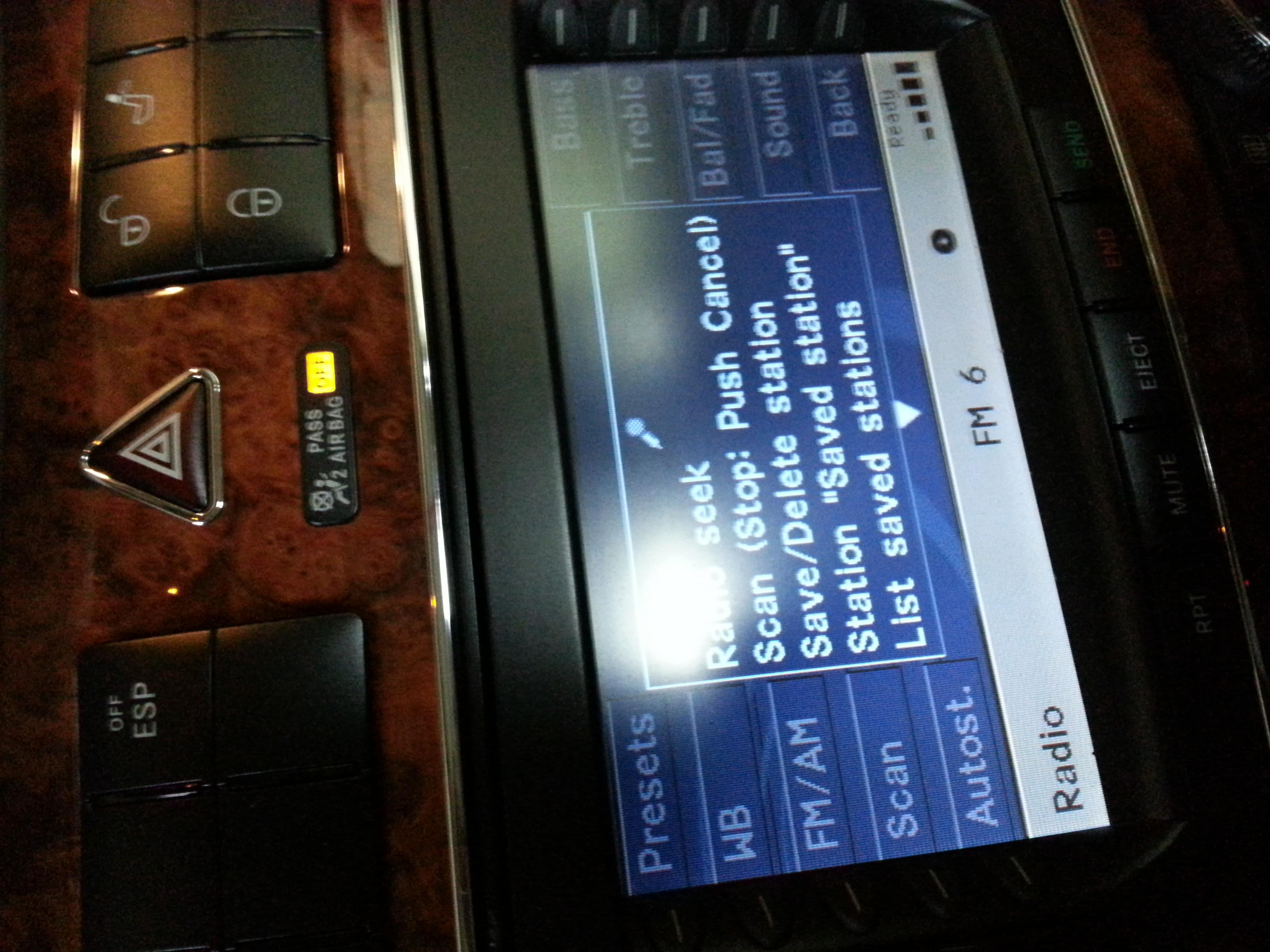

ok .the 2038208285 works great..i can control the radio.cd ..phone and the navigation..i will keep the english lady as back up..lol..about 3 years ago .i had ask the dealer if i can add voice control and he said no...oh well,
