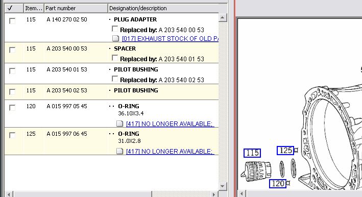

If you replaced the pilot bushing with the revised part, you should not need to replace it again. The seal doesn't go bad over time. It was a bad seal design/material that caused leaks.

I'm not sure when it was finally corrected, but it revised three times. Also, the O-rings were available as separate parts, but that was discontinued. I believe the bushing itself was redesigned so that the old or-rings would no longer fit. Here's the revision history (no dates, though):
http://benzbits.com/722_6/PilotBushing.JPG
