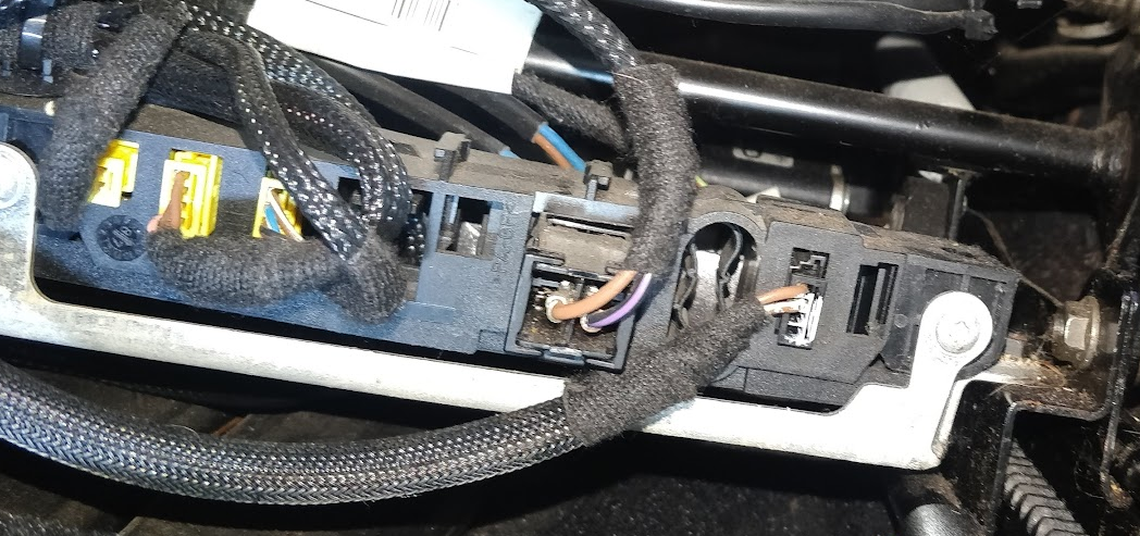

under the passenger seat there is a wire that gets damaged. Its a common thing and an easy fix. Look under the seat you can probably see it.

thanks for the heads up. Is there any pictures of the wire? is it attached from the back or the front? I see a ton of wires under the seat.
I've sort of tried to push them all in already.

best pic i could find
Attached Thumbnails CLK 350 900b error-13219893_10154811738319018_375881029_n.jpg

That worked! Its located at the front of the passenger seat. The whole plastic module tray that holds all of the connectors popped off and so must have loosened the connector.
I popped it back together and squeezed the connector and the port together. The port that the plug connects to was loose itself, so they had to be squeezed together.
After that it worked.

I think I spoke too soon. I started playing with the seat buttons and it came up again. I played with the wires and there's nothing obviously wrong. But now the light is solid on and won't clear away with the tool.
Before it would come and go as the seat is sat on\moved.
face palm

Hi! I apologize for commenting on an older thread, but I didn't see where I could do a new post. Really quick, I have an SRS error and it's for the passenger seatbelt. I checked the wiring from the seatbelt under the passenger seat and it's not connected to anything...bingo! My only problem is that I can't find where I need to connect it. I'm hoping someone can take a look at the pictures and maybe give me some guidance?
This pic is closer to the door. Those yellow and blue wires are the ones from the seatbelt that are just hanging and not connected to anything.
This pic is closer to the console.
