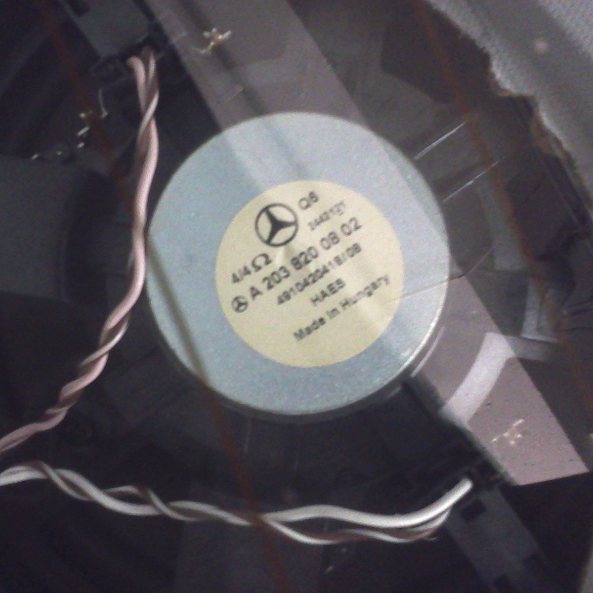

Hi. Since one of the four door speakers in my European manual transmission 2003 CLK240 (C209) has a ruptured cone, I am considering upgrading all four speakers to something a little better. I don’t listen to that much music in the car so it does not have to be a huge upgrade. Anyway, since I am trying to avoid the expense of removing the door panels just to check what speakers were installed by mercedes, I am not sure about their specifications. I checked the subwoofer above the trunk (please see attached photo) but there is no brand there, only a reference number from mercedes. The audio unit installed in my car is the Audio 10 with 6 cd changer.
Using the reference number above can anyone tell me what speakers are installed in my car?

Thanks. I am not 100% sure but I think my current speakers are indeed 4 ohm. I know the subwoofer (mercedes part A 203 820 41 02) is. I also know the tweeters are 8 ohm (mercedes part A 203 820 08 02). It's just the door speakers I have no idea. I also don't know what the wattage is.
