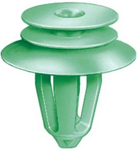

hey, are these the clips that I should have on hand if I pull the door panel?

Yes, those are the clips. And you definitely have to pull the door panel. The wood is screwed in from the back, and the switches clip to the wood from the back. And the window switches and trunk release are all one piece. When you remove it from the wood, be careful to press them straight out. You will be tempted to grab the window switches and tilt one end up, which can break very thin pieces of plastic that hold the trunk switch in. Then you will also need super glue.

There really isn't anything you can do about the clips breaking. They just do. MB sells a new design now that may hold up better. If you do remove the panel, post back and I can give you a couple tips.

...The clips are also amazingly brittle for no apparent reason.
yeah, the generic clips I bought at a local auto store are much sturdier....
