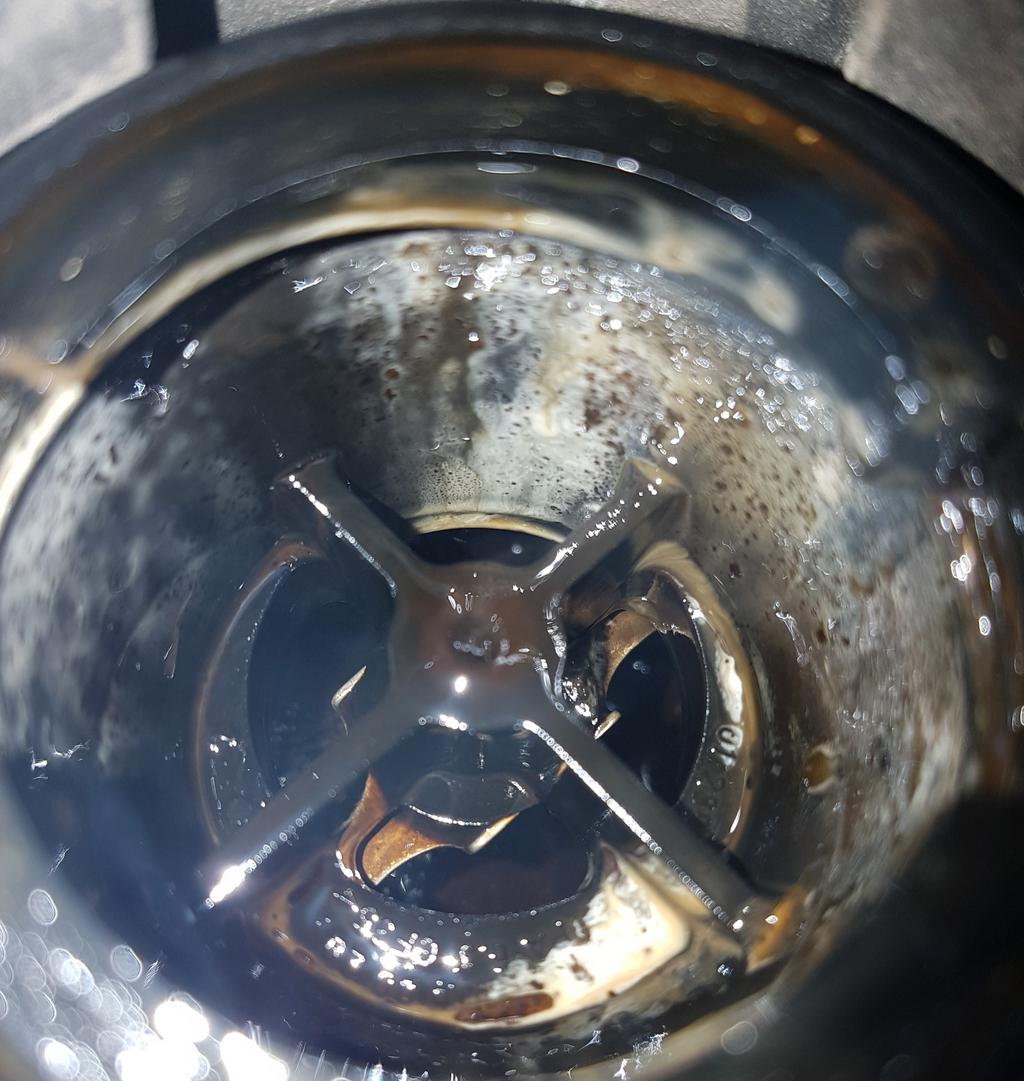

Sad development. Checked the oil cap again today and here it is:
Sent the pic to my mechanic and he's is saying it's either the cooler inside the radiator or the separate oil cooler next to the oil cap since my car is european spec and has the separate cooler.​​​​​​

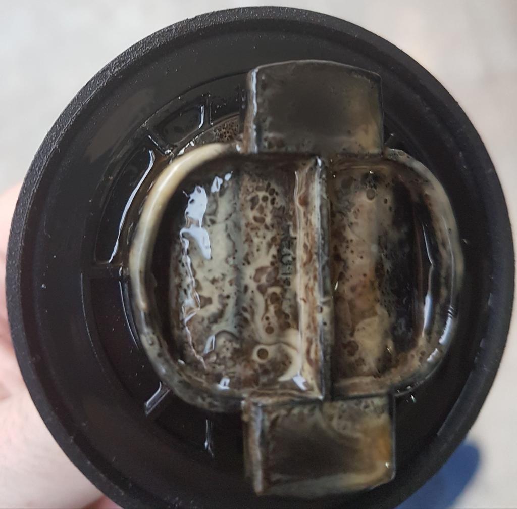

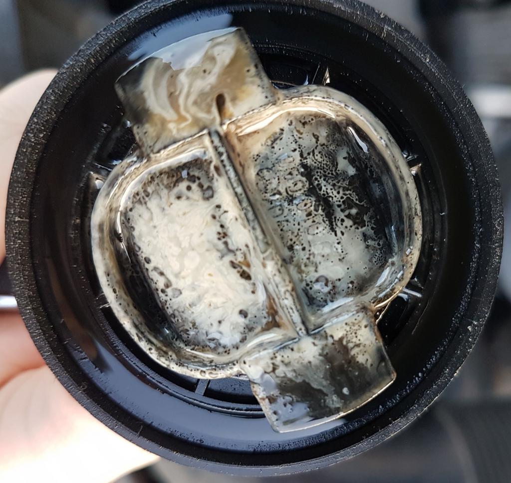

Pictures below are after a 35-minute trip this morning. I am stopping to drive the car until I take it to the garage and get it fixed.
Oh dear. The milky residue is generally a sign of a head gasket needing replacement There are some other signs to look for such as excessive water/condensation from the exhaust pipe. I'm not an expert, but I don't think it can be a faulty radiator. The problem these cars have is with coolant mixing with transmission oil in the radiator although to my knowledge that was rectified in CLKs manufactured after September 2003. Having a cracked oil cooler may be the problem. Having new oil cooler seals won't necessarily matter if the structure is cracked somewhere (as mine was). Replacing the oil cooler is a cheap fix. Perhaps try that before you go doing the head gasket which will cost a bomb in labor.

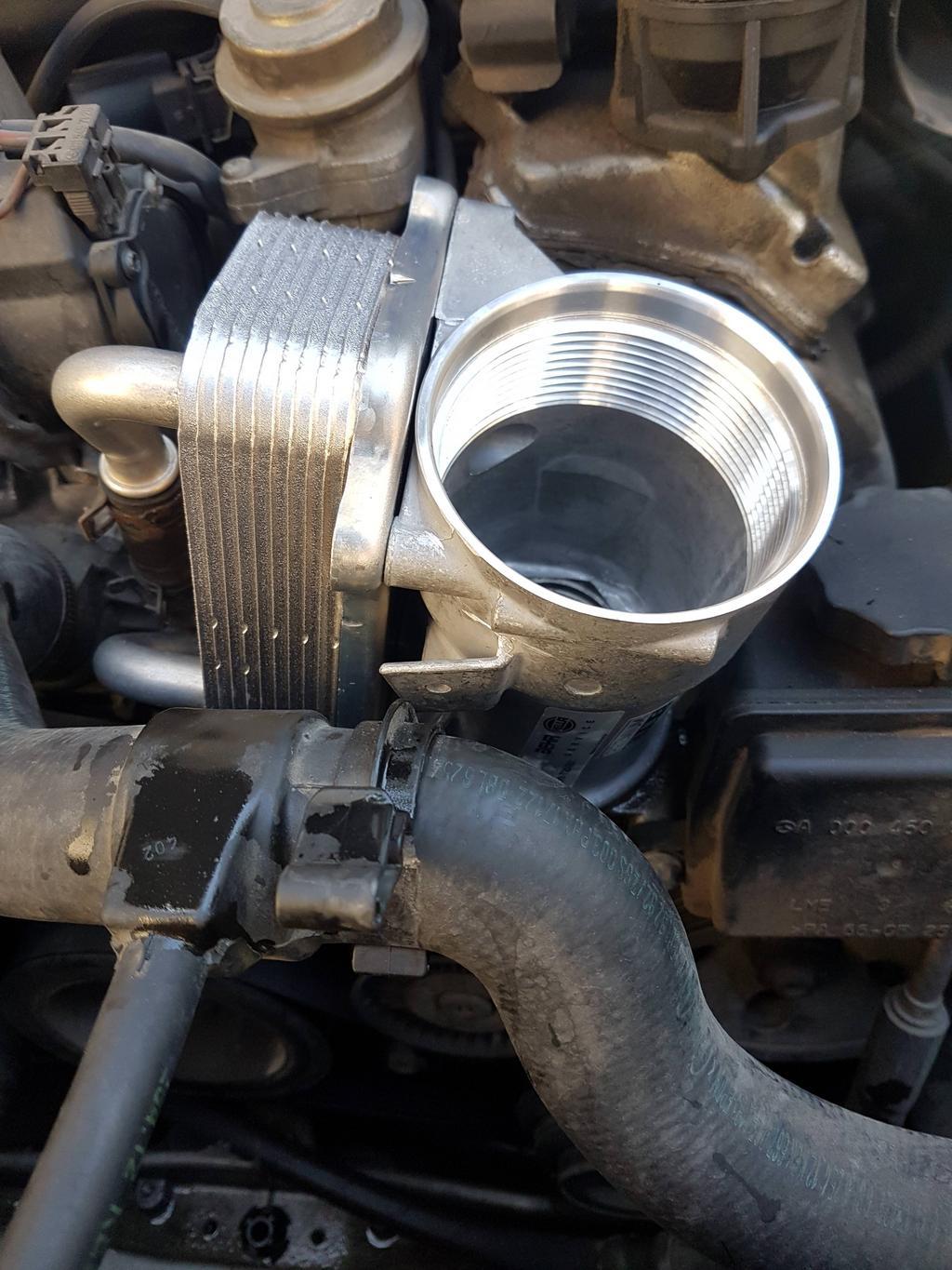

So we changed the oil cooler today and cleaned the oil cap (picture attached). I separated the oil cooler from the oil filter housing, but couldn't see any defect except if I were to cut the cooler in half using a saw and I couldn't do that today. Maybe next weekend.
I'll keep cleaning the oil cap until it no longer has the milky mix.
