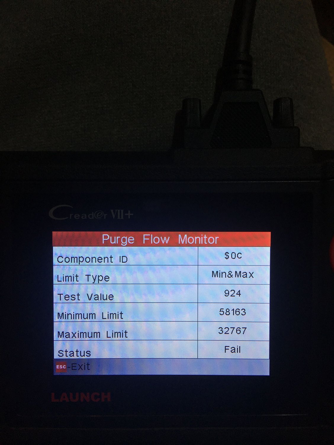

I'm not sure if this is relevant to the issue or not, but the car did fail one EVAP test (0.040") as shown:
I think it failed because I never took the car out for a proper drive cycle while I was reading these codes and values. However thats just my educated guess.

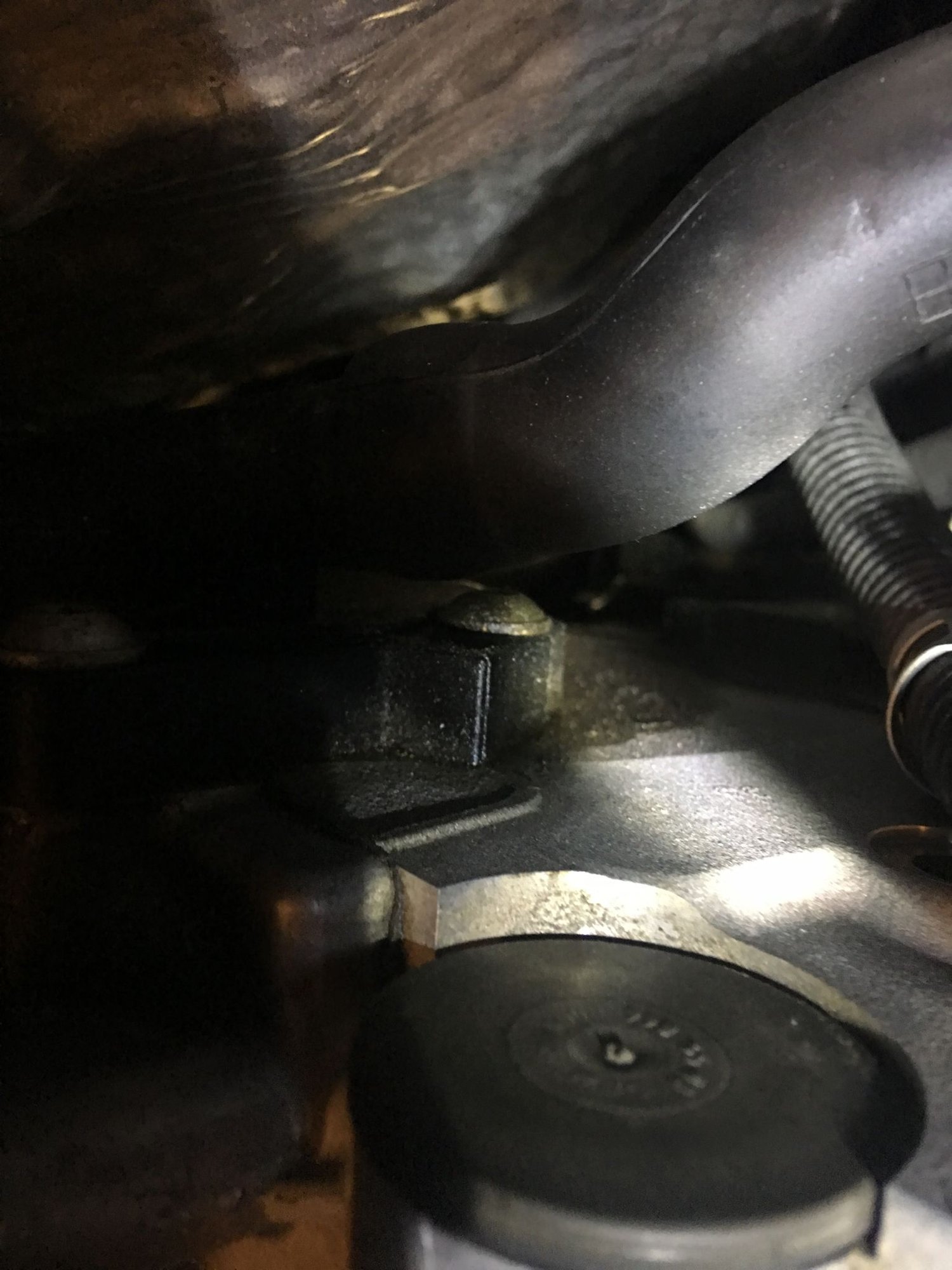

Oil Leak!
So it was oil leaking. The source was the left-most (passenger side; back of the engine) engine oil separator cover that has the hose connecting to the MAF. It has 4 star screws in it. Using a handy mirror, I saw a very very slow leak and everything around there was discolored. The same place on the other side of the engine was beautifully clean.
I'm not sure what to do with this information now. Did the oil leak poison the oxygen sensors? Is this a common problem? I know that those covers in the back of the engine go bad often, however I thought it was usually the smaller ones without the screws in them.
With this new information, can someone shed some light on me?

Each of those two OBDII codes relate to three different MBZ-specific DTCs with different diagnostic steps and potential causes, including a bad MAF sensor, pressure sensor, O2 sensors, vacuum leaks, and even a weak fuel pump. You're going to need to get a proper diagnosis if the codes persist.
As for the leak, replace the cover on the oil centrifuge - it's cheap and takes only a few minutes. You also need to clean up all the oil, including in the connectors for the O2 sensors, located below the bell housing. That may solve the errors if those connectors were soaked.
