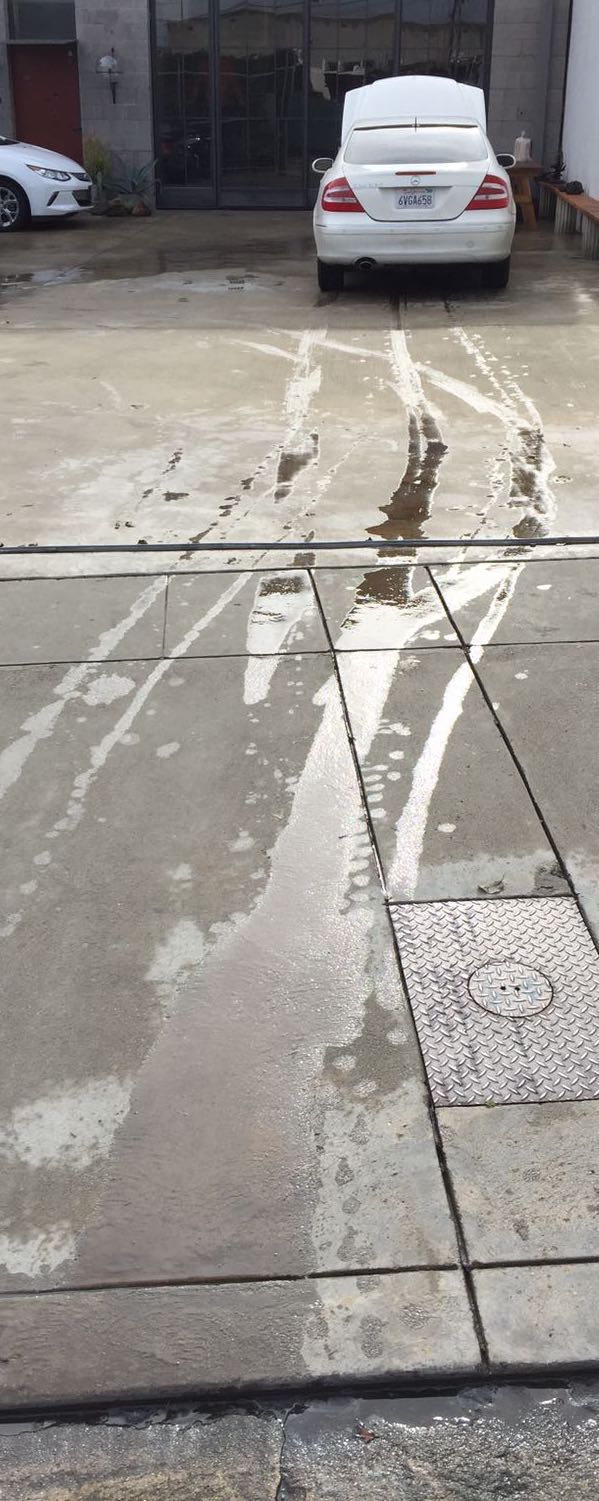

Anyways, I drove it back and the transmission seems to make a pretty soft but noticeable whine when going past 10/15 miles, the pitch increases with RPMs. Is this reason for concern? Below are two pics to give you an indication of the extend of the fluid loss. Thanks so for for the input, it's much appreciated!
UPDATE: Drive it around a bit, and the whine might be coming from the engine itself. It also occurs when the transmission is in neutral and I rev up a bit. Opened the hood and it sounds like the distribution belt is making the noise. I'm suspecting this might be because the transmission fluid jizzed onto it? Here's a short video of the belts:
Attached Thumbnails Tranny oil hose came off after garage visit. Warranty?-02e17ed2-e310-448f-bef6-b1265c4daf8a.jpg   Tranny oil hose came off after garage visit. Warranty?-img_0418.jpg

Even with the transmission in neutral and the car stopped, the torque converter and main fluid pump are running. If those were deprived of fluid, there could be damage. You'd have to lift the car and listen to the bell housing to see if that's the source.
