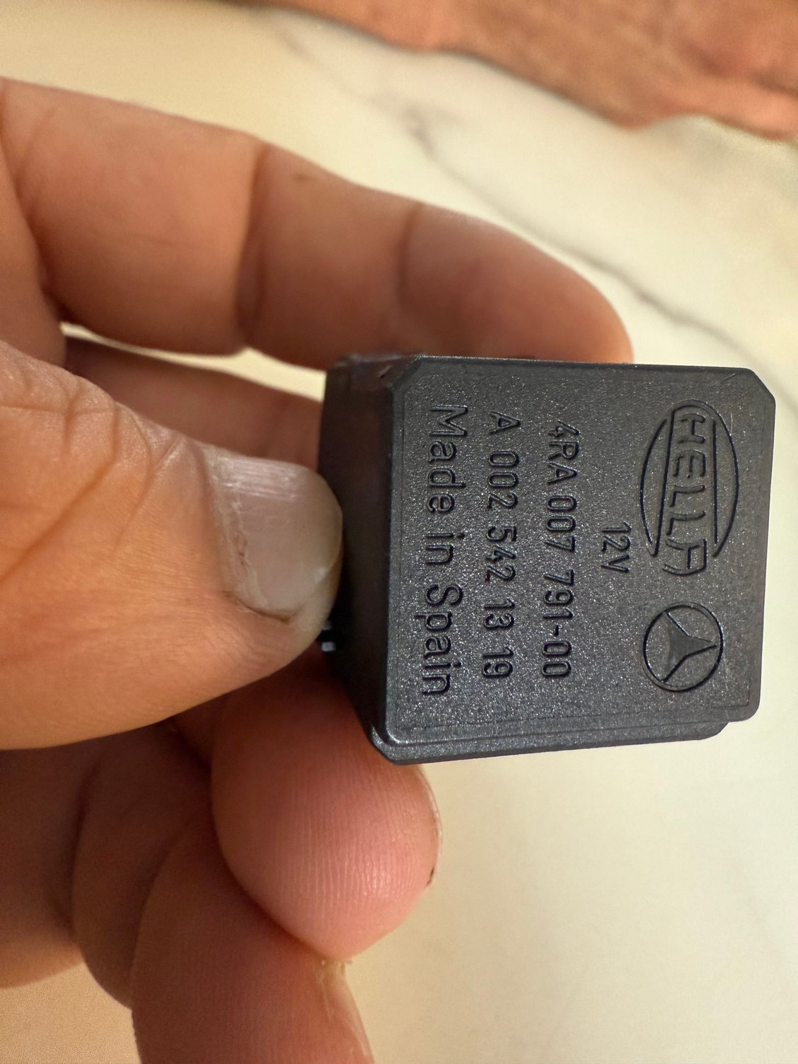

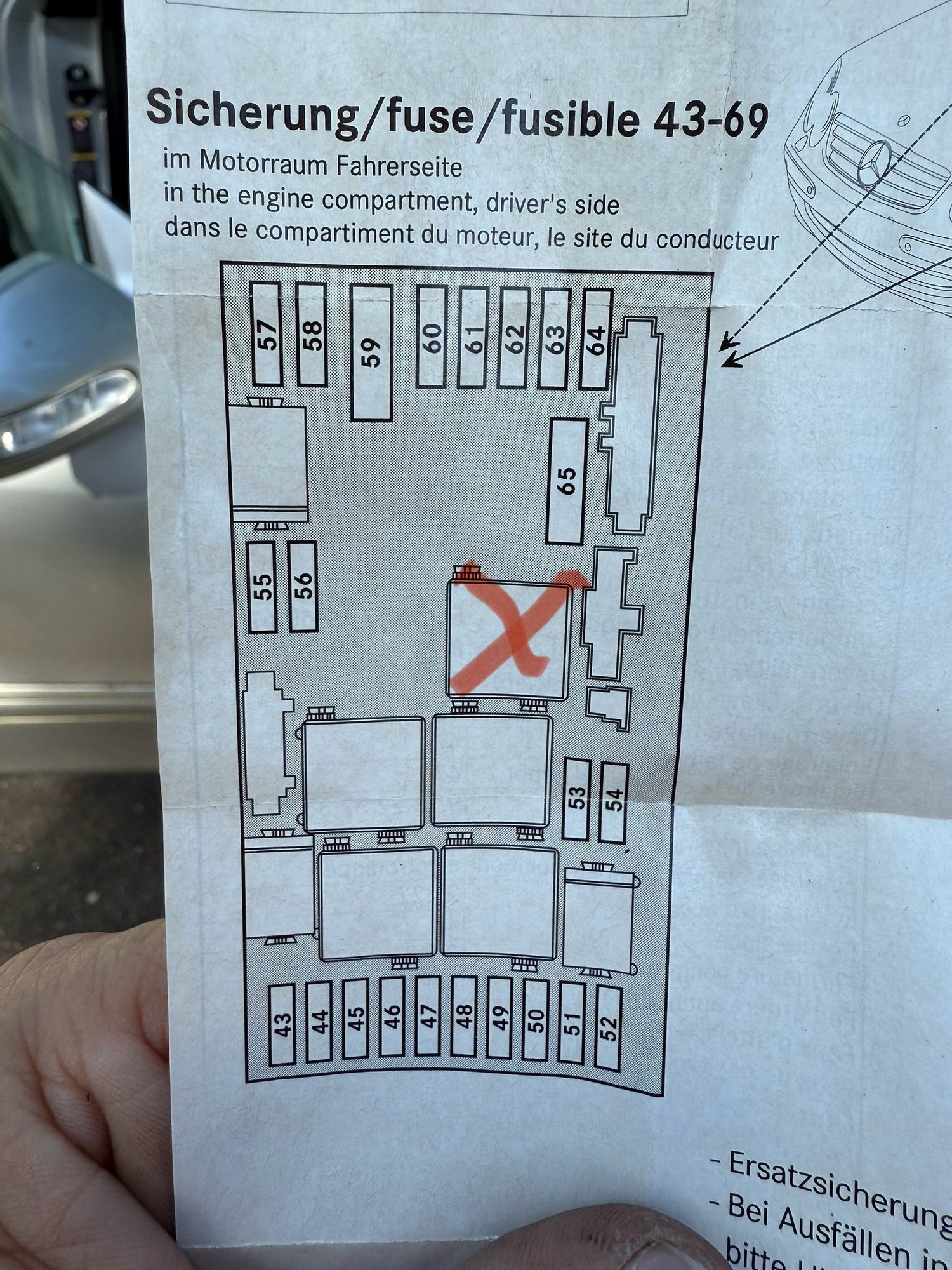

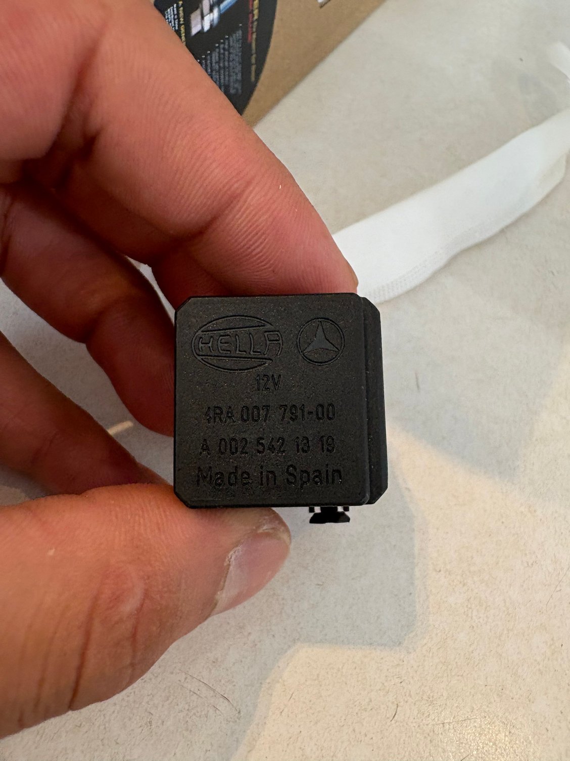

Hi All, as this is a very old thread, I thought it might still be interesting because just had this issue.
With thanks to all who have replied to this before, Suspecting Temperature sensor and ECU goes way too far.
I had the exact same symptoms on my 2004 W209 with M112 (240) . All light come on when turning the key (except Water Temperature which remains 0 or blank) and few seconds later the Radiator Fan goes on full speed.
It turned out to be from the start enable relay (K40 ?). It is one of the black relays on the front SAM. Marked with Red Cross in my photo.
I opened the casing of the relay and pushed it by hand and Voila everything worked.
Just to make sure I swapped the two black relays and the symptoms changed. So, that was our bad guy.
Hope it helps.

No Start Fan High
Originally Posted by knv
Hi. Yes, same symptoms.
key on position 2. Nothing happened first. No starter. No error, then Radiator Fan started on high Rev. until I turn the key back. In that time the water temperature shows maximum. One i replaced the black relay everything was ok again. I don’t thhink your ECU would be faulty.
try this relay first.
regards
adrian
