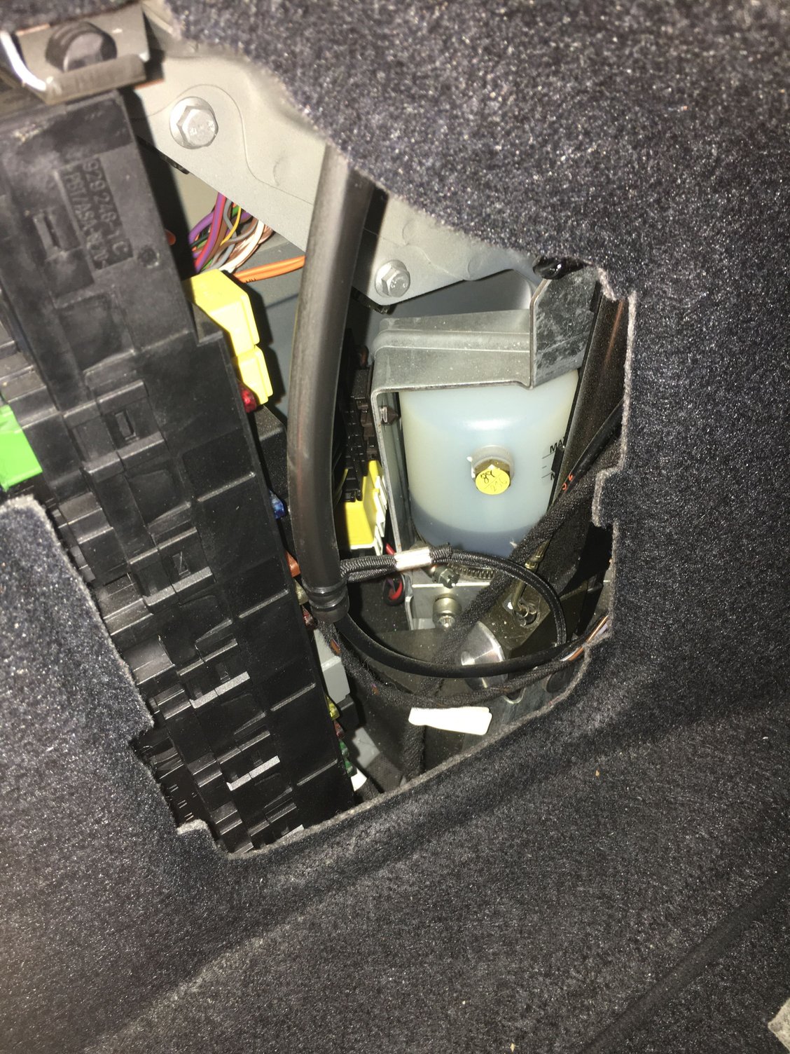

The obvious first step is to check the fluid level in the top reservoir. If you don't know how, in your trunk on that same side there is a door on the side maybe 5" wide and 8" tall in the black fuzzy side panel. Pull it off. The reservoir will have a clearly marked "Full" line.

I checked the level. Level is low. Where is it leaking from?

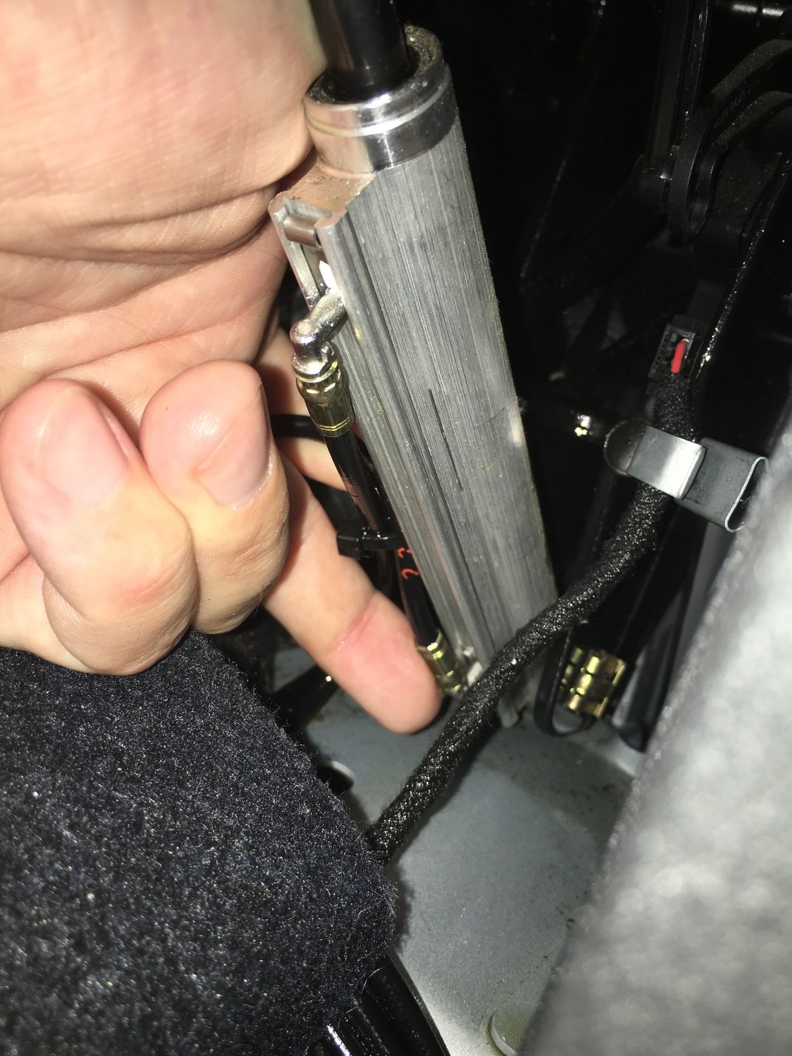

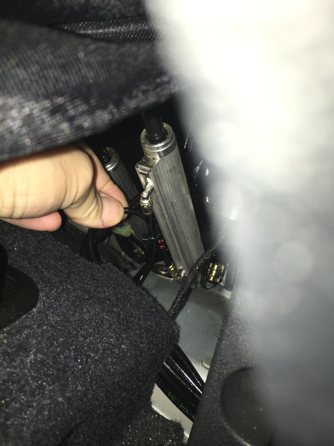

Found the culprit. It's a cracked line. Sprays everywhere! It's the number 22 line that connects to this cylinder. Now just need the part number .

Driver side bow tension cylinder
