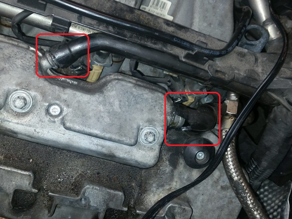

I broke the ends off 2 of those hoses while replacing my valve cover gaskets on a CLK55
https://www.partsgeek.com/ss/?i=1&ssq=Rein+22+9810+008&x=0&y=0
$23 to replace them all. The old ones were so rigid I had to razor slice down the side to pop them off the MAF.
I ran the car while the ends were broken (taped them up) and did not experience a rough idle so that might not be your problem
Attachment 441244

haha ok we might be talking about different hoses then
The kit i linked has 2 hoses coming from the top of the valve cover on driver-side, and 1 coming from pass-side. They connect to the side of the MAF at the rear of the engine.
That pic is from the driver-side with the airbox and coil packs removed.
edit
yep MAP =/= MAF lol.
Sorry, good luck.

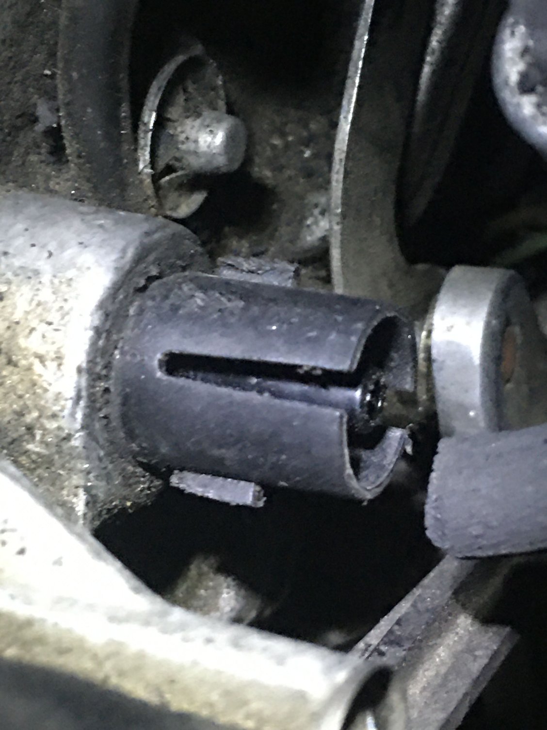

Here’s the pic I forgot to attach
Here’s a picture that I took last week. It’s not the best but I circled where it connects. I don’t recall mine feeling loose in anyway. I’ll take a look later today or tomorrow. It’s raining today. My issue was that it keeps ripping on the side where it connects to the map sensor, I keep cutting the end and reconnecting hoping it eventually stops tearing cause eventually the hose won’t reach.

Originally Posted by BK627
Kevin were you able to figure out how to remove that hose from the manifold? I need to replace mine as well but there seems to be some kind of clamp holding it together and there’s not too much room to work with.
Did you get it out? Read my reply to Kevin, I also attached a picture.

Get a small box cutter and cut the vacuum hose on both side then pull the hose, insert the new hose.
If you still have rough idle after renewing the hose and MAF pressure sensor, unplug the MAF sensor wiring and clean your MAF sensor (use the advice sensor cleaner). It’s where your top air filter housing is hook up by the firewall
