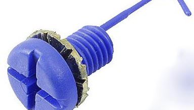

I did notice when I drained the system there was a small metal 'o-ring' in the pan I collected the coolant in, looks like the silver 'notched' ring here.
Slow leak at radiator drain valve / petcock-ti3hqb6.jpg
I put that back on the new drain valve but the leak continues.
I cannot find a part number for this ring anywhere, the one I have looks beat up.

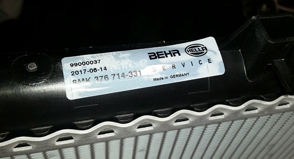

I ordered a new radiator, BEHR 203 500 39 03

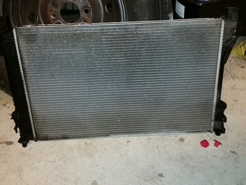

Radiator is replaced. It sucked, I'm bleeding.
Slow leak at radiator drain valve / petcock-cmeeqcj.jpg
Took the bumper to get resprayed while I had it off. This is what 142,000miles looks like. Poor thing

New rad is about 1/4" thinner than the old one.
Slow leak at radiator drain valve / petcock-rlhegxm.jpg

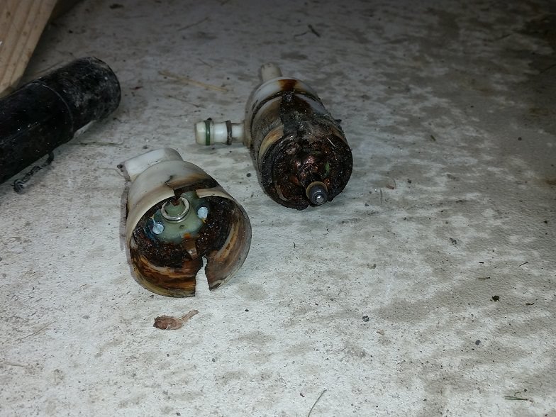

And I'm pretty sure I found the leak from my windshield washer fluid!

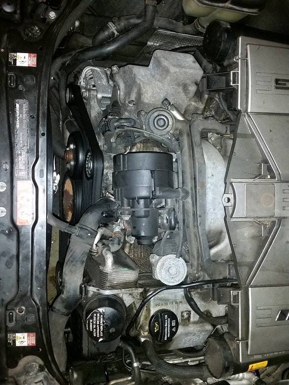

And with the bumper gone I was able to get to the bottom of the washer fluid container and find the leak. It was on the backside of the reservoir in pic #2. Looks like the pump for the headlight washers (that I've never ever used) went through some freeze cycles and exploded. New one on the way for $20.
