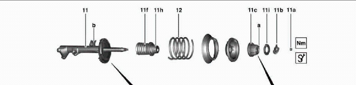

ensure top strut cap is mounted correctly on strut
Originally Posted by tich65a
Done that, and it's a bit better, so thanks for your advice.
Maybe it will settle a bit more after a few miles....
Regarding front height issue, ensure top strut caps are aligned & mounted correctly on strut. Strut cap is somewhat cone shaped but cap is shorter on one side vs other side. If unsure of alignment, go to MB dealership and they can provide you schematic of correct alignment. I recently reinstalled my front struts but I did one at a time, using the other as a template for proper strut caps alignment.
Good idea... thanks ..
I have the MB workshop manuals where this is explained in some detail ..
