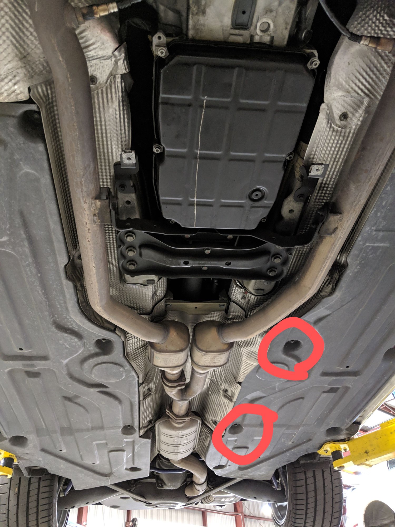

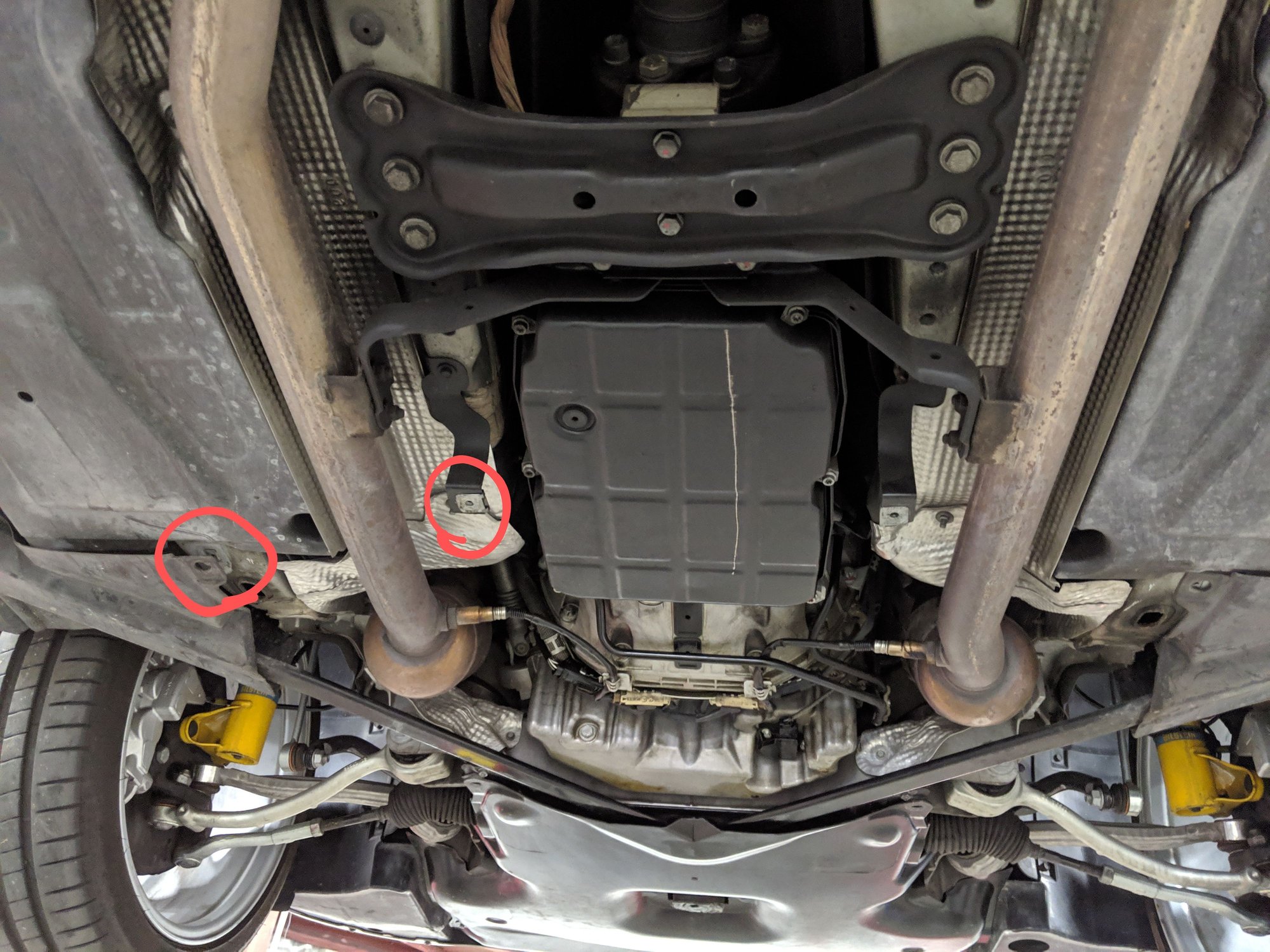

Jul 2, 2020 | 02:21 PM
Sure, here is couple of pictures
Retaining clip up close
More retaining clips
Plastic nuts

Jul 2, 2020 | 02:30 PM
Hmm... found one more: second picture left most (circled in red) retaining clip is 001-994-98-45

Jul 2, 2020 | 03:18 PM
Quote: More retaining clips
So the one closer to the wheel is the exact spot I'm aiming at. Mine is missing... the problem is, there looks to be a frame rail or floor member above this, which has a small square opening, looks too small for the clip to enter... that is what I'm struggling with, how would I even get a clip in there? Or is that a plastic fastner that I just can't identify yet... thanks again for all of the help... frustrating how the parts blow ups don't show the bolts/clips/fastners with numbers... looks like a bolt on the drawing I found, but can find no reference to it.
Reply 0
Jul 2, 2020 | 04:14 PM
That one should be 001-994-98-45.
https://www.google.com/search?q=0019...w=1858&bih=926
I think you simply need to insert it into the square hole.
