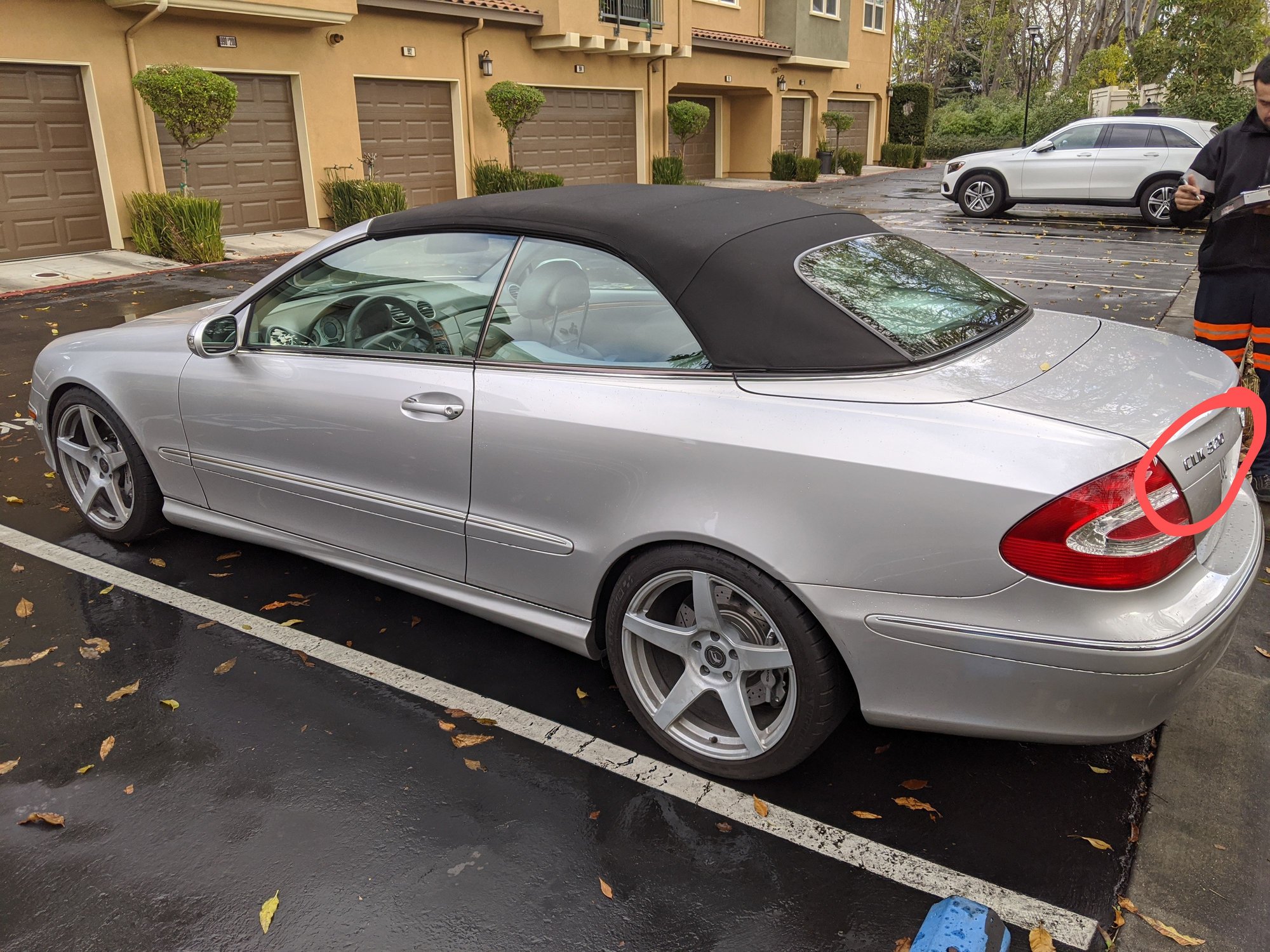

Before (16" wheels)
After (I know it's hard to see, but it's all i have, right after installing = suspension is not settled)
Front and rear after suspension is settled

18" wheels
Rear spring pads #4

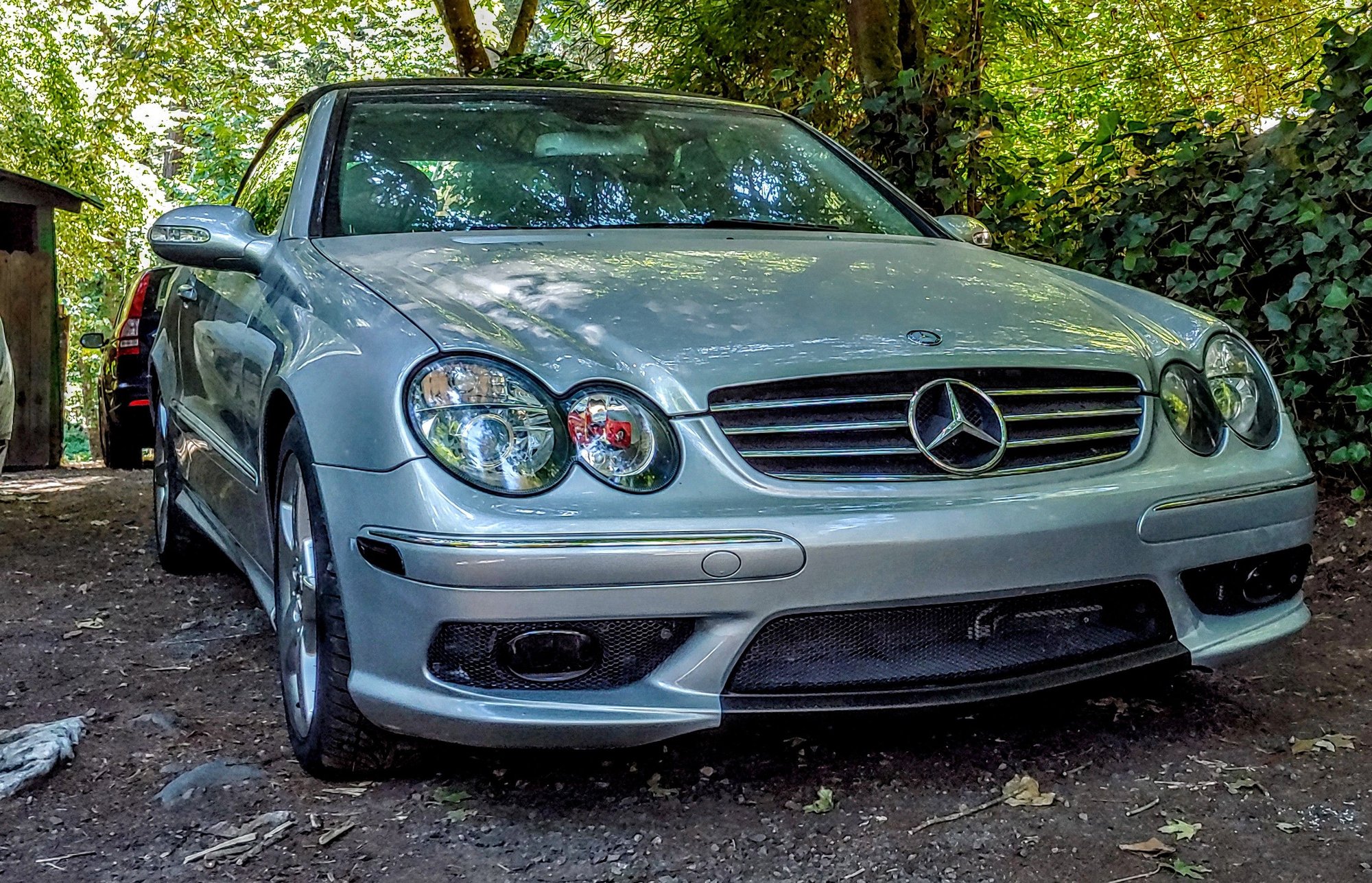

Not the best angles, but you can see the difference in the front height. I do scrap a tiny bit leaving my driveway, and did not before. I honestly don't feel that the ride quality is poor at all, I live way out in the country and we have some very bad roads out here, but the car takes the bumps with very little harshness. I want to be clear that you DO feel the road more, and it definitely IS translated to the chassis more. But, in no way (at least to me) does the ride feel poor or "aftermarket" it feels more responsive and more direct. I just went on a weekend outing and drove some very aggressive back roads with my wife and kids, nobody feels the ride is to firm or harsh. Again these are my opinions, I can only say how the car feels to me. But, I would 100% recommend this kit.

Look, you're not doing 3.2 l, are you? Judging by the brakes.. And the rear bumper doesn't look like an AMG.
Old Aug 4, 2020 | 10:34 AM
dzmitry's Avatar
Joined: Jul 2016
Posts: 478
Likes: 109
From: California
2023 E450 AT, 1996 S420, (sold) 2004 CLK320 Convertible (v8, 6 speed)
At least officially it's still clk320, although it's seating without the engine waiting for v8 right now :-D. I installed amg brakes couple of years ago.
Here is proof
