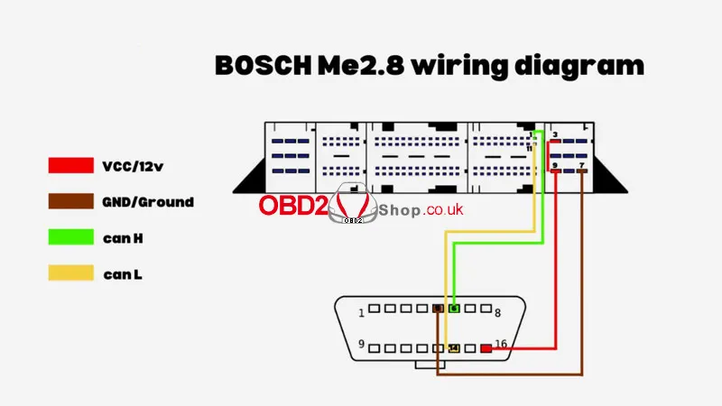

You could try to measure resistance between CAN-H and CAN-L on the ECU connector https://miro.medium.com/v2/resize:fi...5ezMW1O8o1.jpg
Resistance should be around 60 Ohm, but be sure that the car is completely off, since you removed your ECU I'd image that you already disconnected your batter . Otherwise not "sleeping" modules could mess-up reading.
Reply 0
Oct 14, 2023 | 03:53 PM
Thanks for the diagram! Got ECU back from SAI. The resistance between the CAN-L and CAN-H pins on the bench is about 100-120 ohms. Not sure my cheap multimeter is super accurate. At least it isn't an order of magnitude off! Haven't put it in the car yet to try testing at the OBD2 connector and see if those C1022 and C1038 errors are still there because it is crappy weather outside. Maybe tomorrow.
