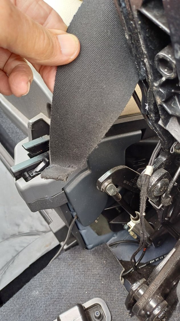

Old Jun 2, 2025 | 09:28 AM
Eamonn Hayden's Avatar
Joined: Jun 2025
SL 300 1993, CLK 200 convertible 2005
Fix for fabric sticking out
I used some elastic to pull the fabric back in. Sew it to the lower corner of the flap inside the soft top and then secure the elastic to the frame of the soft top while pulling it slightly.
Before the fix
Before the fix
Sew the elastic to the flap
Secure the elastic to the frame of the soft top
After the fix
After the fix

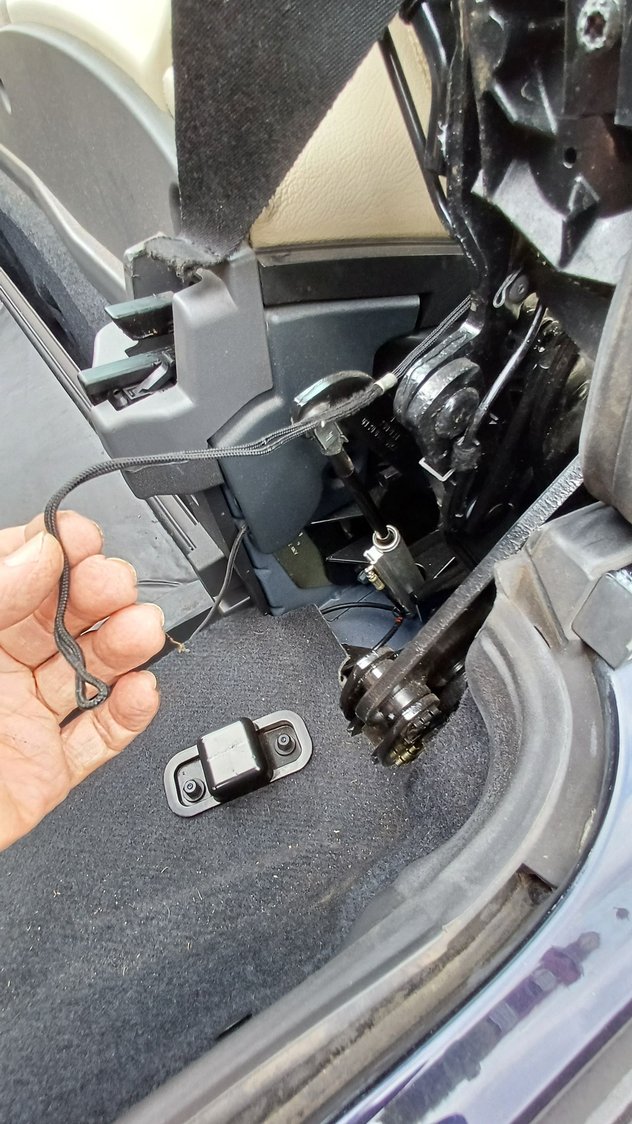

Hi all, in addition to Eamonn's great post above, I've found this video on youtube
which is easy to follow. Also, I have a question about a couple of other bits on the soft top that I haven't been able to find anything about. These parts aren't connected to anything....
The same parts are also loose on the other side of the car as well. The roof works perfectly ok, so they don't seem critical, but it would be nice to fix them back where they're supposed to be.
